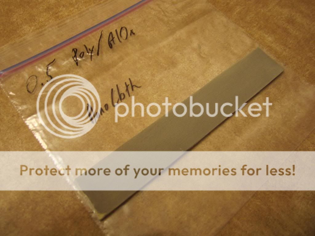

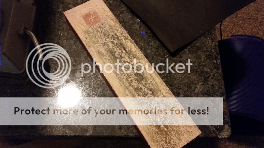

I also have some nice traditional leather on wood strops, but it is pretty easy to round the edge with them. I've gotten much better results with simple, cheap, homemade denim-on-paint-stick strops. They are much more forgiving and less likely to round the edge in my experience. I've tried various compounds on them, and for simple stainless and carbon steels have the best luck with Ryobi white "H", Mother's Mag, and Bark River green.
