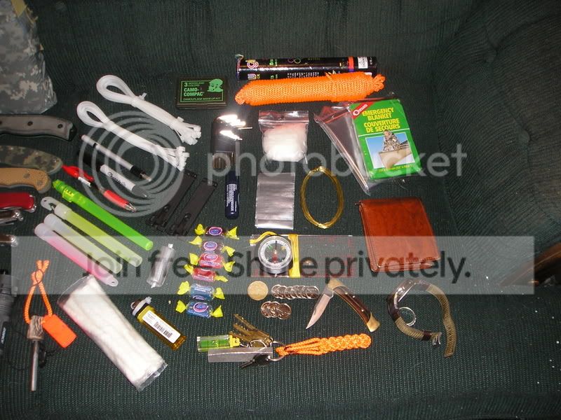

Hey guys,
Well, I have been going through my kit as of now, and I cant seem to find a happy medium. I have the room almost for everything now, Shelter, fire, water, navagation, signaling the works. But I just can't get it to a comparable size to weight ratio.
Now, its kind of a two in one kit, its for the city loafing and woods alike, but there are some things Im not sure I need/want in there, and I need some advice.
these are the things I plan on removing now:
-Vic Rucksack(have a multitool and CRKT in pack)
-Also, I think I can get away with not having all the mini glo sticks, I would like to keep the core ones, but the others( in the black tube, back right) can go.
things I need some advice on:
-The heavy duty heat blanket. It takes up alot of room, and im wondering if you guys think I could get away with two of the plain mylar space blankets.
Things I should add:
-A pot of some type for boil/cooking. I can right now sift the big stuff out with the handkerchief, then treat the water with chemicals in the canteen, but they take 30 minutes to be %100 done(is that a bad time frame?) If I removed the heavy duty blanket could I get away with the two mylar blankets? I haven't used them much and am wondering if I should invest in a AMK sheet.
Misc:
The RC6, canteen, keys, ring, watch, Spyderco, wallet, buck 55 and lighter ride in my pockets, the rest is in the Lunada.
Sorry for rambling guys, Im just at the final stages of setting up the kit and Im kinda stuck. :o
Thanks everyone.
I like zippos,think you have one there if im not mistaken. But I really would not depend on one because the fliud is terrible anymore,doesnt last. wont save wieght but I would replace with a bic.
I have to be honest here.
Why in God's name do you need 4 folding knives?
Drop 3 of those and home and rotate them. But I just don't see the need for that much steel.
Want - YES! Need - no....
TF
Keep the multi, and the Mili, drop the rest. This is assuming you have a fixed blade on your belt. If it were me. Id keep the multi or the sak, and add in a small fixed blade. Project W, Izula, becker necker etc....
Lose a flashlight, If you have spare batteries, I dont see the need for 2.
Go with a mylar AMK heatsheet. The heavier ones are nice, but the amk will do the trick.
Add a Guyot. It will double as a cookpot.
Add a spork.
You can replace the cordage with jute twine. Its good, cheap, and doubles as a kickass tinder. Any fatwood? I would add in a hunk.
Why the camo compact? Again, I dont see the need. If you really need camo, mud and natural camo will work.
Looks good, those are just things I would change.
I'd get rid of the CRKT folder as well.
Other items to thin out:
Lose the Zippo and the cheap orange lighter. Get two orange Mini Bic lighters. They're better quality and not much bigger than one of the cheap clear lighters.
Get rid of some of the dental cotton.
Put the Allen wrench set in your car. You'll probably have more use for it there than is a wilderness survival situation. If it comes down to urban survival, you can get them out of your car when you need them.
I'd think about removing one of the three flashlights if space was still an issue.
If you are using the camo compac as a signal mirror, keep it. If not, that would go too.

If this is an emergency kit I think I would do the following
Keep the straight knife and the Vic.
It looks like you have 3 flashlights, one will probably be enough
One packet of nylon fasteners should do since you have some cord.
Get rid of the zippo
One pen
I think too many glow sticks
Looks like you have two fire starters one should do
I'm not sure you need allen wrenches
Camo compac? Whats that? Do you really need that?
The little mylar space blankets-- Unfold one of those and see if you think they will work. I don't. My opinion is they are junk. Toss an extra blanket in the car or a coat.
That's just my thoughts. It's your pack and you can do as you like I think you might just have too much stuff. My opinion only.

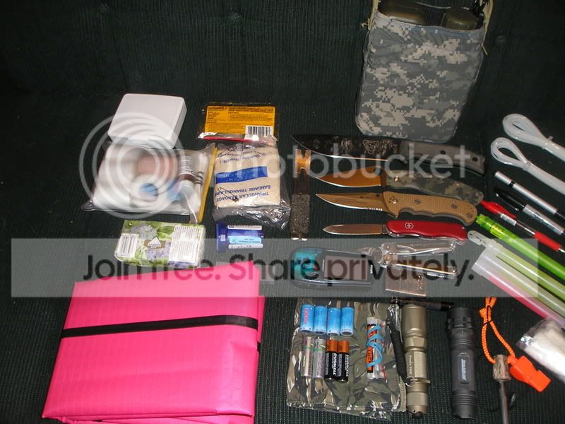

Couple things you might think about...
Instead of carrying flashlights, get one of those head lamp flashlights. It will take up a little less space than one of your bigger lights and it will give you two free hands to work with. You'll have to try a few out to get one that is actually bright and easy to replace the batteries on.
Instead of the magnesium block with flint, scrape your magnesium into a contact lens carrier. It saves time in building the fire and takes up a lot less space in the kit. One side of the contact lens carrier will hold enough scrapings for 2 or 3 fires and you already have another flint or ferro rod in the kit.
I think I see some tenderquicks ( is that what's in the plastic bag beside the bic (type) lighter?) Why not do the ranger rick thing and combine the two, if you look on his rangerdigest site he tells how to modify the lighter into a one handed (sparklite type) firestarter. Then cut the bottom off the lighter ( after completely draining the fluid) and fill that cavity with your tenderquick (or PJCB). On this note, I have been wondering how well it would work to go ahead and roll some PJCBs in magnesium shavings then store them that way you already have everything ready to go just need a spark and your burning.
David
if you plan on using your HD space blanket as shelter, there are lighter options, but none will have the dual purpose. i carry mine year round. it's the bulkiest item in my edc pack but i fold it up nice and tight and it goes in the bottom (camelback trailblazer in summer, 3000ci ruck in winter).
my thoughts-
knives- i carry an edc pocket knife and only carry a small fixed in the pack, although i may add a multi tool.
lightsticks- i would say two would be enough.
flashllights- keep one, replace one with a lightweight led headlamp.
drop the zippo.
drop the camo.
you could probably make do with one pack of zip ties.
why the allen wrenches? i don't see any of your gear that necessitates them.
what are the black things to the right of the sharpee?
what is the white stuff in the plastic bag to the right of the firesteel?
what's in the white case above the first aid kit?
You will get alot of advice on this subject. I don't personally carry a survival kit, per se.... but I'll comment on what I see of yours... since you have asked.
Drop
- extra flashlights
- keep only the spyderco on you. (and the fixed blade when in the woods) keep the multitool and drop the rest.
- camo compact. (we are going to have to talk about this.... lol.)
- If that is a handwarmer in the upper left, drop it. (when it is acually cold enough to need one they don't work.
- prybar (urban survival?... maybe. If not, ditch it.)
- hex key set (if you are mountain biking bring the ones you need (only 2) ditch the rest.)
- Zippo
- (1) bundle of zip ties
- cheap emergency blankets
- What's the pink thing? nevermind, drop it.
- the orange cord
- glow braclets (we really need to have a talk)
- square canteen
Add
- small fixed blade
- AMK Heatsheet
- Guyot or a canteen/cup combo
- Jute cord roll.
- spider wire 50lb

If it was my kit, I'd:
Get rid of the CRKT, the SAK, and the knife toward the bottom of the pic.
Get rid of most or all of those glow sticks.
Pare down to one flashlight. Replace that one flashlight with a smaller, solar charged one, and get rid of all those spare batteries.
Get rid of the tiny prybar.
Get rid of the candy.
Maybe get rid of the zippo, since you already have a ferro rod and a butane lighter.
