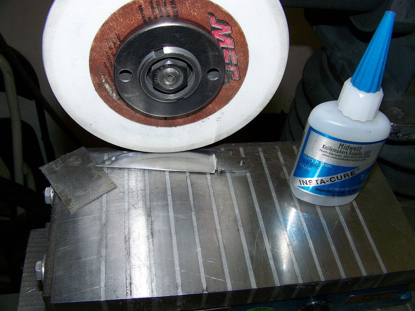

I tried the flycutter route and had the same troubles your having. I went to a stone and solved all my problems. One really nice thing is you can grind it in after the heat treating is finished. Simply dress the stone down to the about a 4" diameter and dress a knife edged 45 degree angle on it.

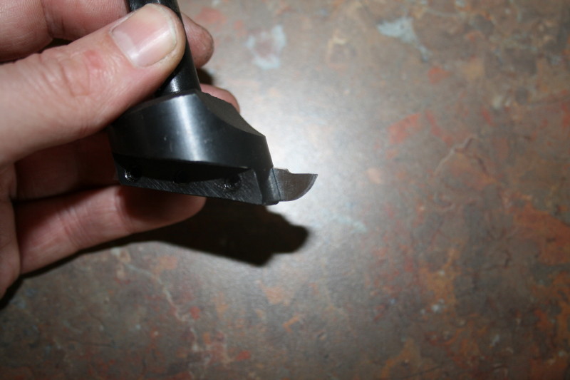

Here is the actual cutter I use though.

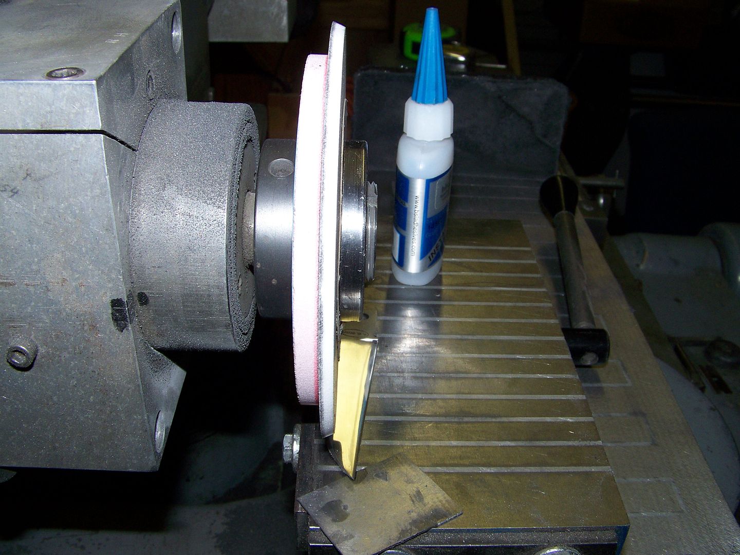

Here is a couple shots of my method. I hope you can see well enough. The neat thing is it is very precise and the stone can be touched up with a diamond file for the last few clean up grinds.
I use a surface grinder but theres no reason you can do this same thing in the milling machine vertical instead of horizontal like this.

I cant tell what grit it is but its a Norton I think about an 80grit. It is only .150" thick and I dressed it down from 6" to 5". I dressed the angle on with a diamond file to about 35-40 deg. angle. I played around with different angles on scrap steel until I liked the width of the nick
John send me a bit and i will grind it for you. Carbide breaks easy. I may cut one or 12 before i resharpen. You want to flood the material or dont use cutting flood at all. Go .005 deaper than center. It took me a year to work it all out. Your nick will look very large but you will grinding half of it off. I mill is running 1000rpm. Feed is about .0005 at time. It seems to cut well at even higher rpm if you are useing good cutting flood.
I use a stone in the mill Norton 38A100-IVBE.
Dress the angle with a sine dresser. I got mine from CDCO Machinery $90.
Blade mounted to a plate held in the vice and cut the nick.
