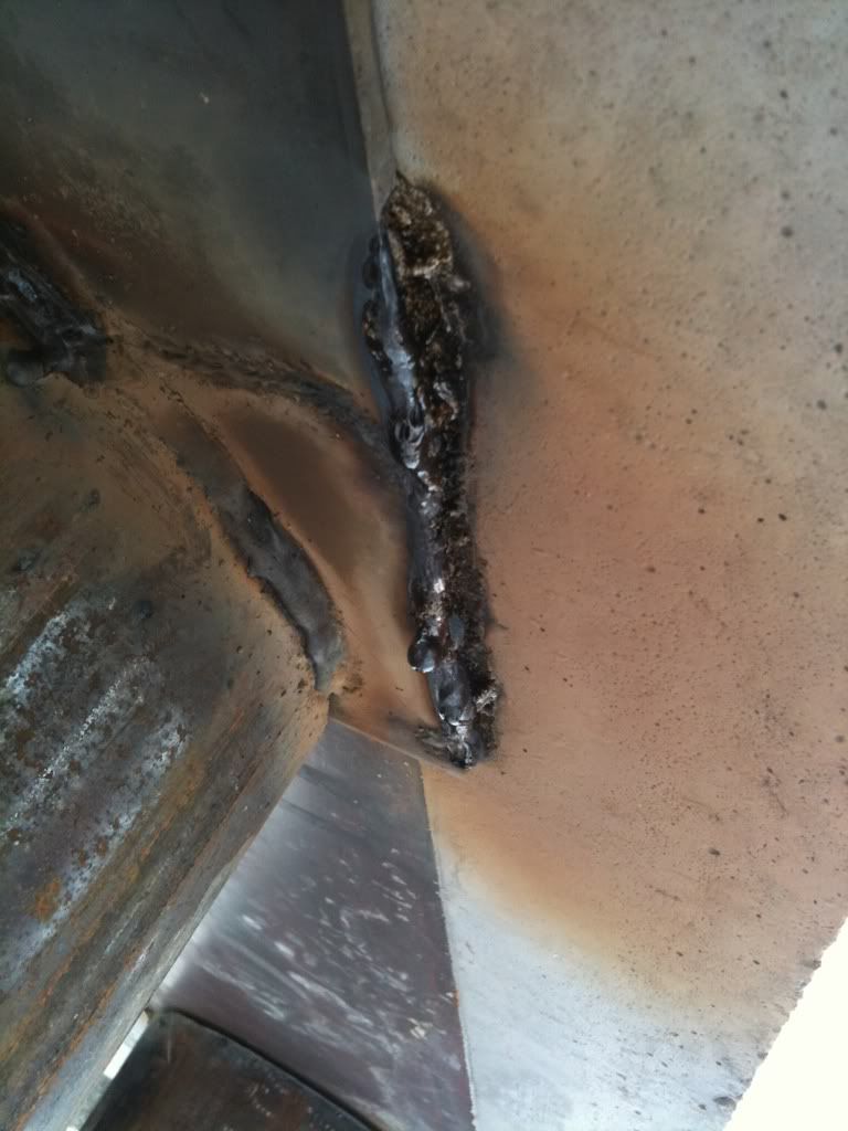

I'm a welder up here in the oil and gas fields of northern B.C.. I found these "welds" underneath a pumpjack that we went to hook up. I put a little more on some of the other ones after I found this:
That's concrete he tried to WELD TO!
I still don't have words to describe the kind of back woods gapped tooth cousin f****r it takes to do something like this

I was going to respond about the concrete, but I noticed your comment about it between the pictures. Mind if I show that picture to a friend?
Wow. That concrete welding pic takes the cake. I've never seen anything so stupid in my entire life, and I see at least one act of mindboggling stupidity every single day. Thanks for sharing!
I want to show that to a friend, and ask "what's wrong with this picture?" Should be good for a laugh!
