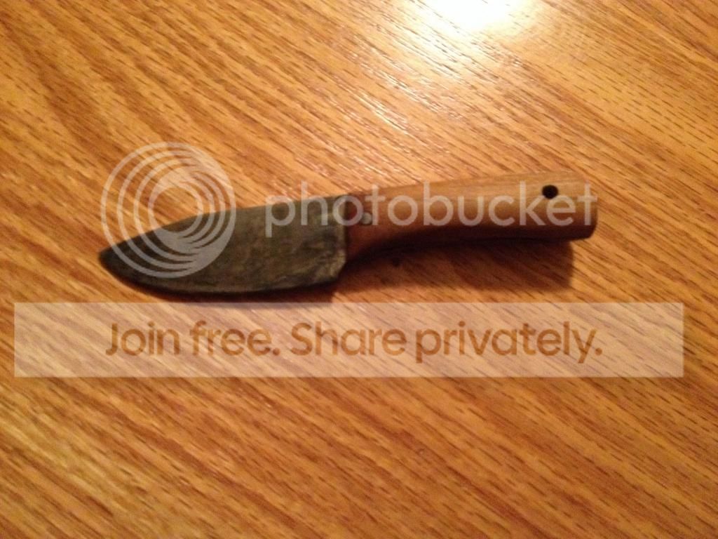

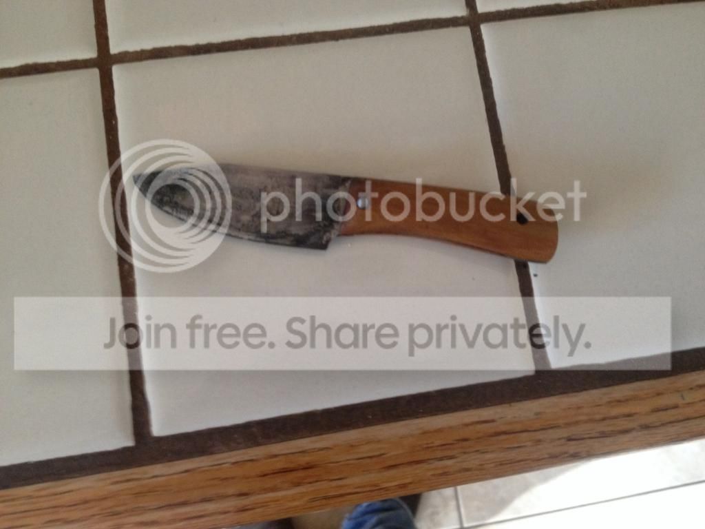

I found a very ugly thing in the garage I had thrown together before I knew anything about knife making. It was a rough blade with Osage scales epoxyed on to the blade with holes through it all and nails holding it all together...pretty bad. The scales were blocks that wernt even bear the same size as the other. I knew it was going to be ugly, but I was going to try to make it as pretty as I could! So here it is, the ugly duckling. I used mustard, yes mustard it works great, to age the blade to hide the nicks I couldn't sand out since it was attached to the scales already. Sorry for the bad pictures

One thing new makers seem afraid to do is go back on a finished knife and do it right. Dull the edge and bust off the handle with a hammer and chisel, then finish the blade properly. Once the blade is right, put a new handle on it. No need to chuck an ugly duckling when you can take it down past the ugly part as well as put new feathers on it.
That makes total sense to me! Thank you. I guess with my next ugly duckling I'll try to strip it down and make it a pretty duckling. I guess I just never thought of doing that, the epoxy was super cementing everything so that never crossed my mind!
Warm the knife in a pot of boiling water or a 250F oven and the epoxy will come apart easily.
Ok, thanks Stacy! I'll work on that when I get home today and try to revive the ugly duckling the best I can! I really appreciate the advice, thank you

Ok. Alright, thank you very much for all your advice! I'm going to strip down that knife tonight and try to make it not an ugly duckling!
Well the ugly duckling turned into the dead duckling so I'm sad. I shouldn't have ripped it apart, but oh well, it was a learning experience!
