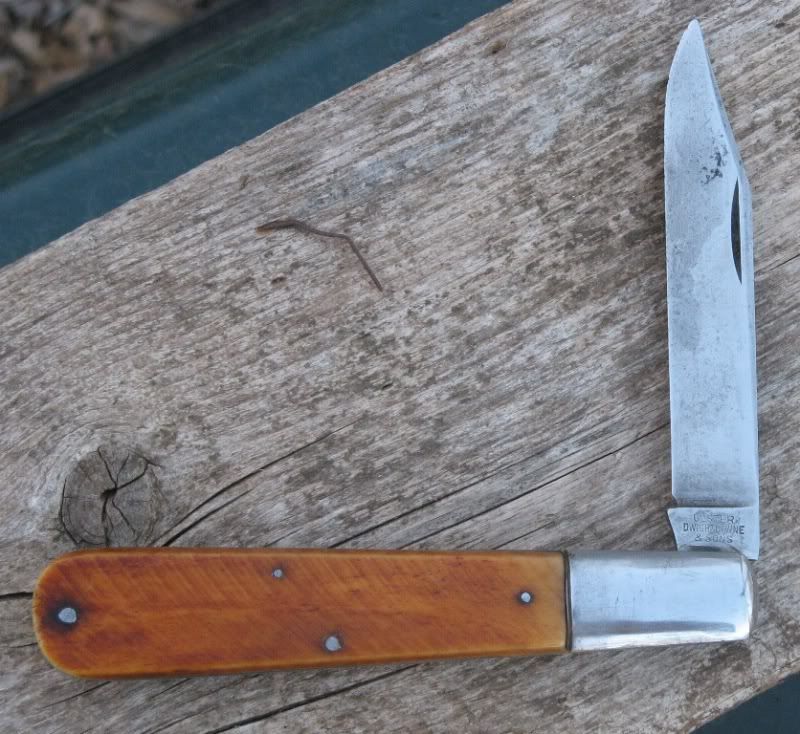

Does anyone have a list of the various Ulster Tang Stamps with approximate dates? I just bought an Ulster, with a three line stamp saying Ulster / Dwight Divine / & Sons. I anticipate this is the stamp variety. This is not the actual knife.

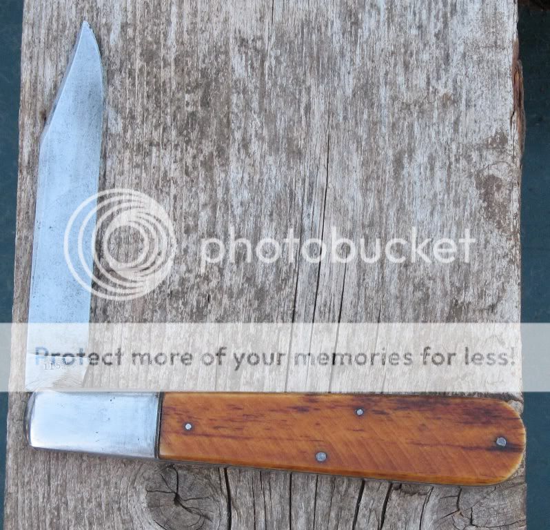

The knife has not arrived yet, but it is stamped 115 3/4 on the pile side. The knife is a Daddy Barlow with sawcut bone handles, 4 pins, no shield. The pic sucks, which probably allowed me to win it.
Here is the actual knife. Just wondering the age. Will post more pics when I get it. Ball cap was not included.
I believe the stamps that include "Sons" was used up to 1940 or so. A precursor to this stamp had only "Son" in it, but I'm not sure when they switched, although something tells me around 1919-early 20's. I've got the info somewhere, now I just have to find it! Not all the knives had the Devine stamping on them, some were just simply stamped Ulster Knife, and some had the Ulster stamp on the mark side and the Devine stamp on the pile side.

Well Roland you are correct about the older Ulsters. This Daddy Barlow pattern 115 3/4 is likely the best made knife I own. Built like a tank, solid half stop, extra strong spring, liners and spring is tight, and pretty saw cut bone. Not sure of the age, the blade appears fairly full. Someone cleaned it up at some point in its life. It has steel pins and bolsters. I'd appreciate knowing the age.

Hal, I'm still looking for my source for the tang information, I know it's here somewhere because I remember reading it not long ago. What I have found is that the Divine and Son name was used from 1900 to 1923, and Divine and Sons was used rom 1923 to 1941. Now I'm not sure if the tang stamps reflected the name change (they seemed pretty frugal with the tang stamp expenditures LOL), but here's a shot of an Ulster box care of LT that shows the "Son" version:
