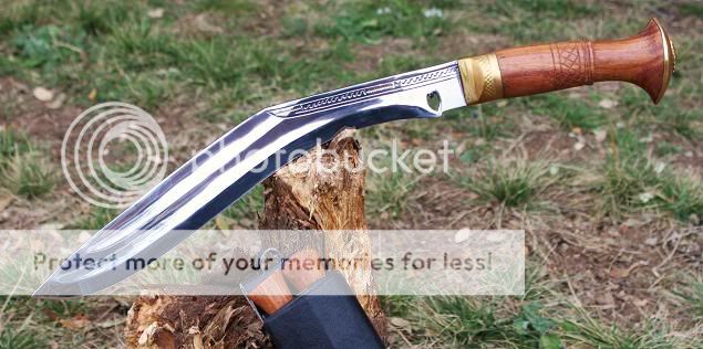

Super CAK, what I consider to be the ultimate khukri :cool:
It's a little over 20" long and weighs a mere 34.45 oz.
Light, fast, and agile, full chiruwa tang and delightfully balanced. I think it was a broadsword in a previous life. It's my favorite because I love the combination of brute force cleaving power with speed and agility.
I'm 6'5" and currently about 230 lbs.

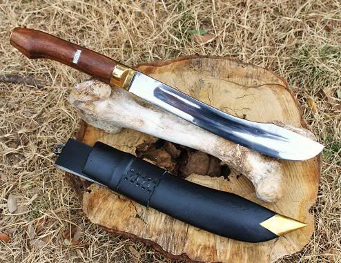

I will also say that this Bonecutter I got recently is very quickly proving itself to be a very nice all around kukri. Good chopper, good weight and a good feel.
16.25 inches overall
11.25 inch blade
5 inch wood handle (full tang)
694 grams
Bevel is 1/3 of the blade that many prefer
The handle is very nicely sized and feels comfortable in the hand. The only thing I think could be done to this design is to follow the lead of other blades with a curved spine and weight forward design; slightly curve the handle to match the curve of the blade and your palm. I have found that the heavy choppers with more weight in the belly greatly benefit from a slightly curved handle.
As a test, hold one of your heavy choppers straight out in front of you. After you hold it there for a few seconds you will feel your wrist want to tilt down slightly. You will also feel the top of the butt plate lean against the back side of your palm (near the wrist). Now, if you have one, pick up an old MKII or M43 that has a curved handle. When you hold that out in front of you, you feel your hand work "with" the curve of the handle, which compensates for the forward weight and you don't get the uneven feel in your wrist or the pressure on the backside of your palm. It produces less hand fatigue and you don't get that sore on your hand. Using one of today's biggest buzzwords in advertising, its an "ergonomic" shape. Its that modern thinking; that was already thought of over a hundred years ago!
