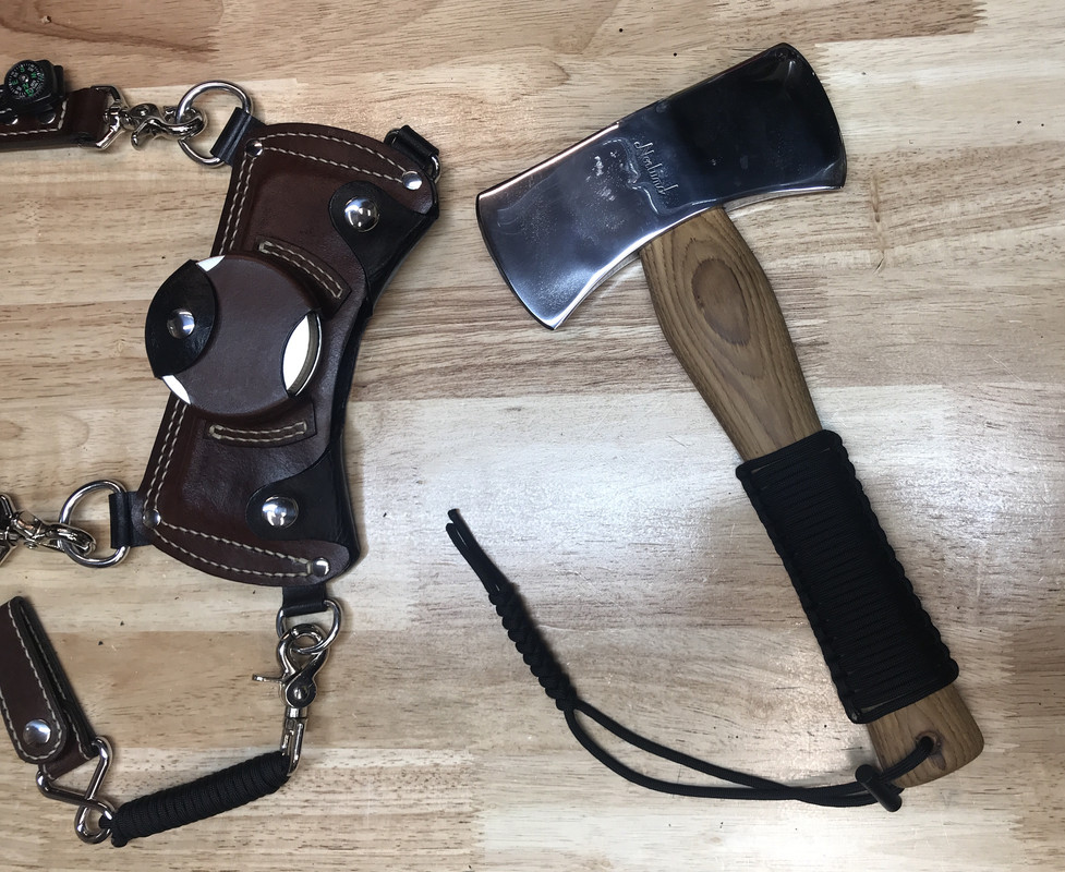

The axe is a Norlund Saddle Cruiser that I polished (accept my apologies) and carved the handle out of Shagbark Hickory. I flame treated and oiled it with natural linseed before doing the wrap and lanyard. (Both are for extra paracord storage and the lanyard bead is a ferro rod.)
The sheath is formed leather and features a tin with a primitive fire starting kit. Including a striking ring, fat wood, char cloth, twine, and flint/chert arrowheads. (I like carrying flint arrowheads for striking. They are already sharp, sparking well, you can use the backside first sparing the tip, and the double-function of having extra arrowheads with you is too cool!)
It has 1” d-rings for the straps and two 3/4” utility d-rings, one of which can be used for the belt retainer. It’s double stitched, reinforced with rivets and has line 24 snaps.
The shoulder strap has holes punched 1” on center for use with both the Conway Buckle and button studs. Being able to place button studs or Chicago screws anywhere allows you to easily remove and reposition the pouches and accessories, adding things as needed.
All the accessories are formed veg tanned leather with two-tone dark brown with black dye and edge paint, natural color thread, and the buttons are all hand polished stainless steel line 20 snaps.
