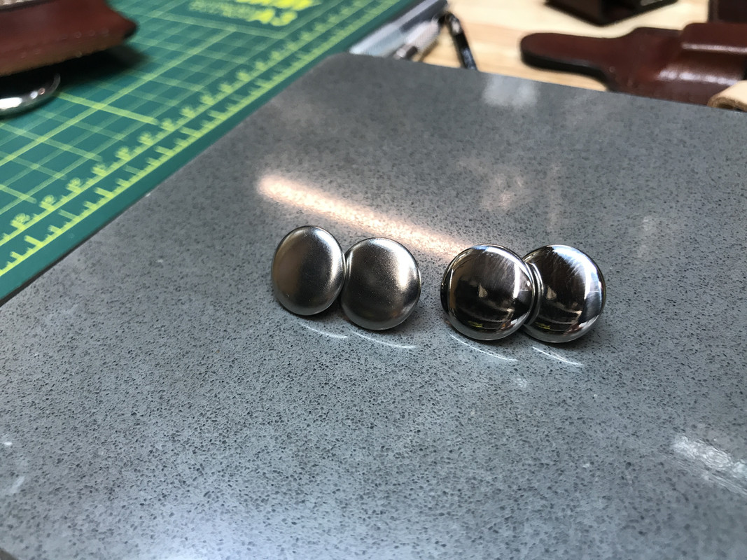

Although I am am in search of and need to start ordering better quality hardware online.(someone gave me a link to an online hardware source that I need to go back and find.) Tandy is just middle of the road and even their heavy duty stuff leaves a little to be desired. Like button snaps, I don’t want to use nickel plated because I don’t want it to wear off. So I get their stainless steel ones but they come very dull so I get out the Dremel tool and polish them up.

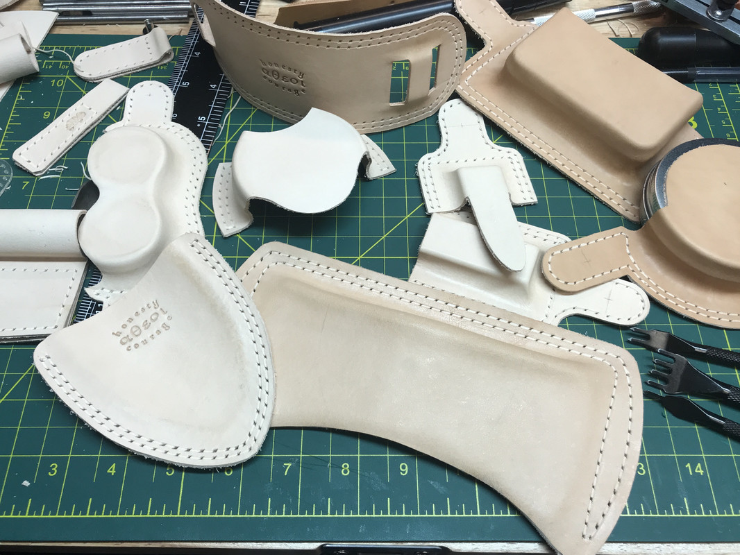

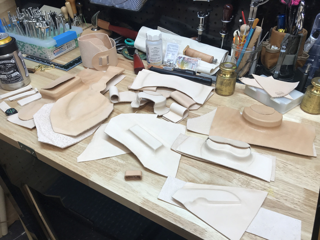

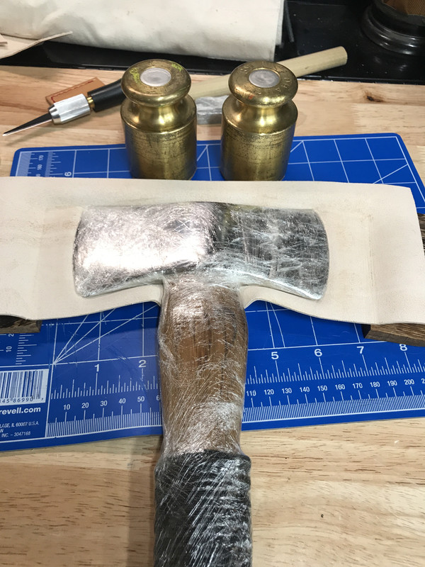

Here are a couple shots of how the sausage was made:

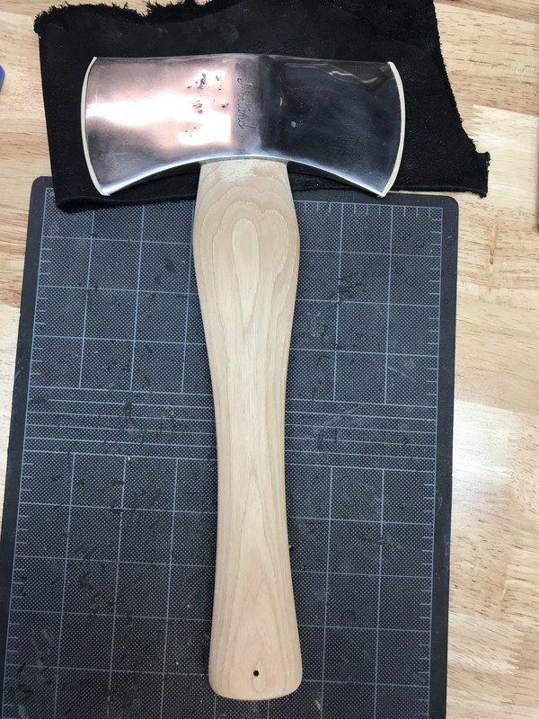

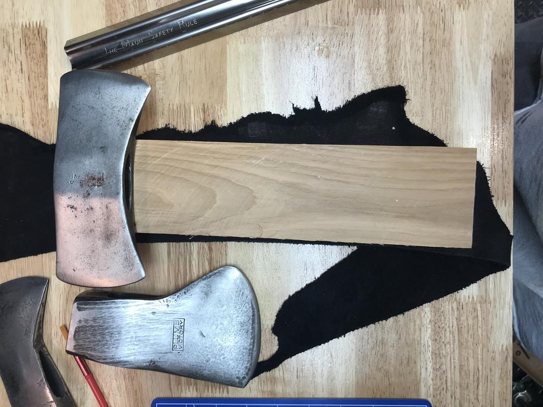

I would like to issue an official apology(in triplicate) for polishing this axe. o_O
Shagbark Hickory for the handle. That side of the wood actually became the back of the handle.
Before flame treating the handle.

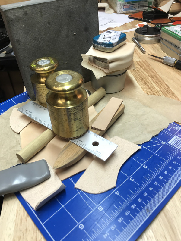

A lot of wet forming on this project!
Chiseling holes for saddle stitching.

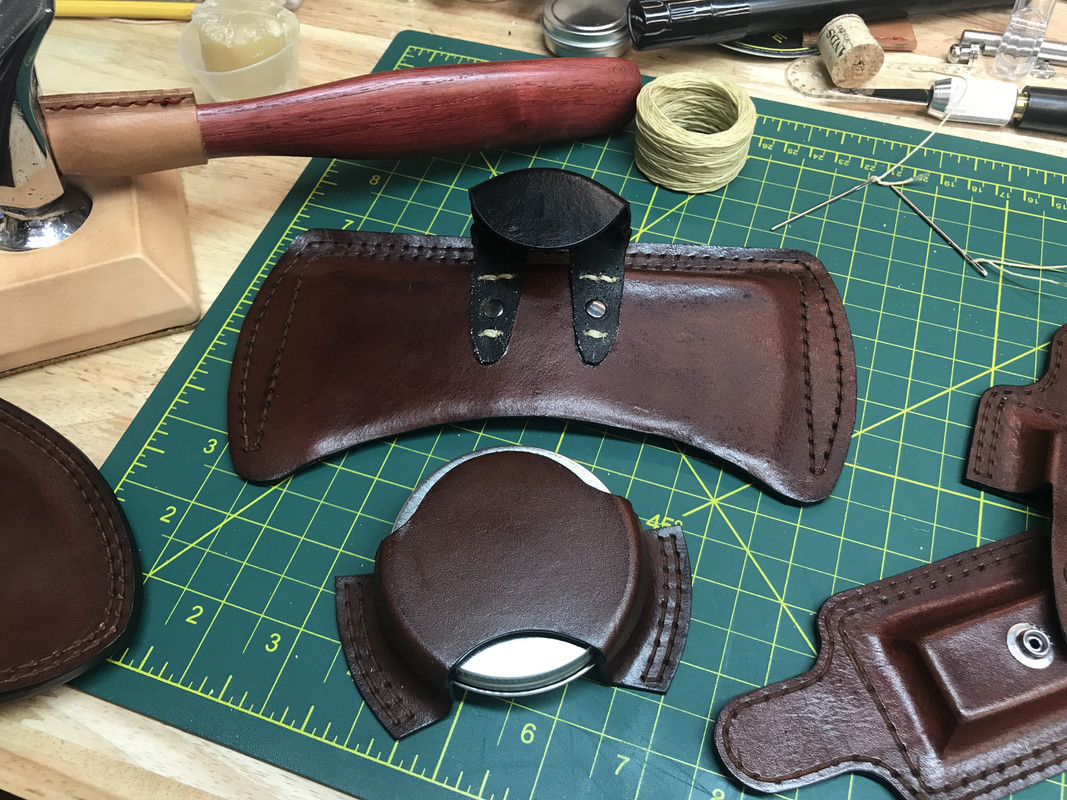

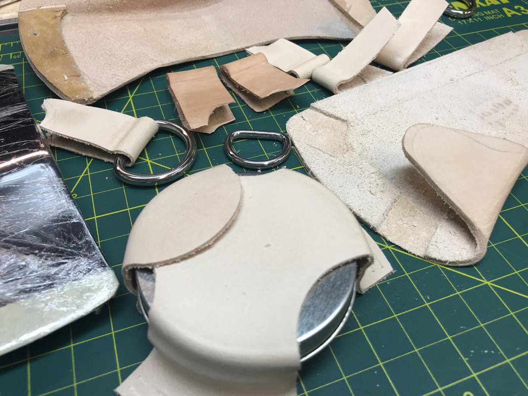

The main sheath was a challenge in its complexity. Skiving the welt so the edges aren’t too fat, cutting groves for the D-ring straps to be stitched into the seam, and making sure to assemble it in the right order always proves to be a puzzle.

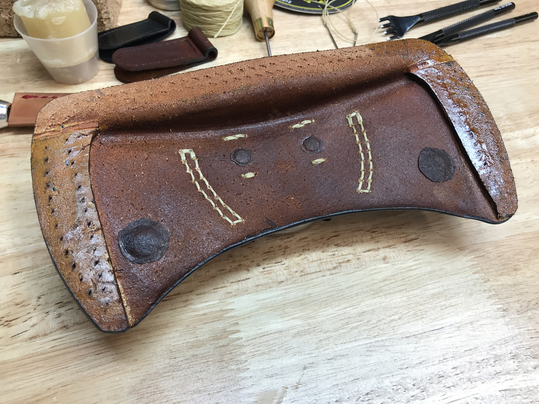

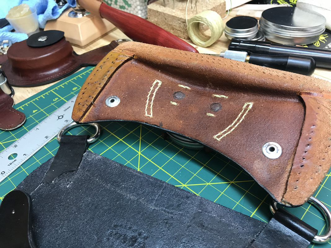

I’ve taken to skiving thin little scraps of leather and gluing them over the rivets on the inside of sheaths so they don’t scratch the axe. (Especially if polished.)
Ready for rivets and final assembly
