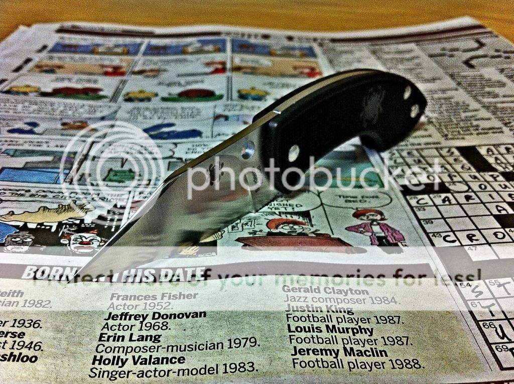

An example of what I mean about lots of steel to work with...

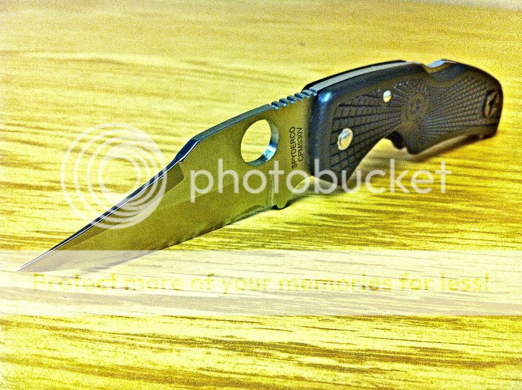

Same model - different mod...

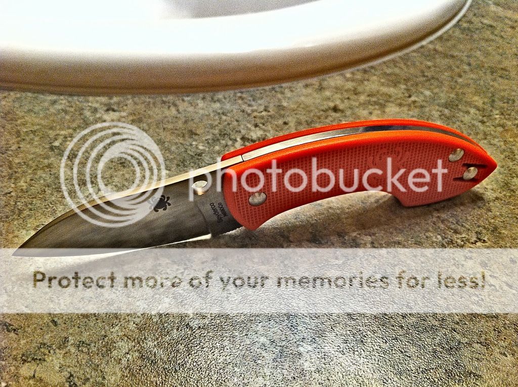

My Native mod...
