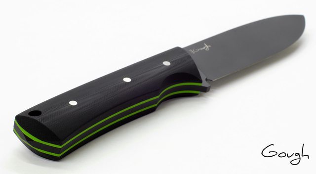

Hey guys!
I'm curious if anyone has tried an ultrasonic cleaner on G10? It would be great if I could remove the 'chalky' appearance from G10 after grinding without having to wash, oil, wash and so on!

With G10 that's actually really not correct James... This is what it looks like when finished to 120 grit:
This is achieved by grinding to 120, washing it really well with detergent, then lightly oiling it, then washing it again... Appearance does not change over time.
Basically dust is getting trapped in the pores of the G10, wetting it out with the oil restores the color. I'm hoping the ultrasonic cleaner will remove the dust completely...
