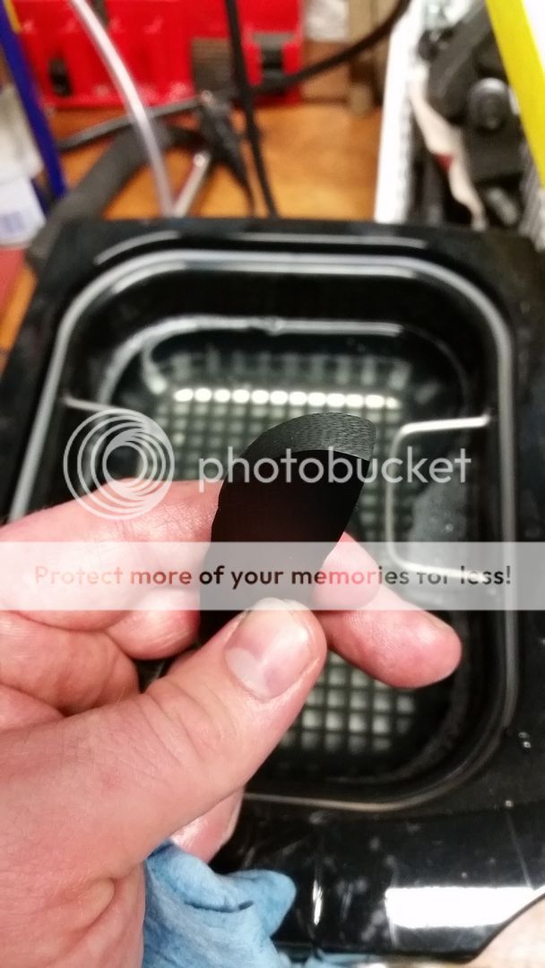

I tried some g10 and homebrew mycarta. I only had cartridge cleaner around so I used that, but I think dawn would have been ok.
The g10 was still faded until I sprayed it with some wd-40.
It did however clean the mycarta really well.

That actually looks pretty good! Normally it would look chalkier than that after grinding! Awesome, I'm excited to try it out now!
Aaron, that was after a spray of wd-40, but I agree, still looks pretty good.

I got my ultrasonic cleaner yesterday, put some G10 in it right away! As Greenjebadiah found, the cleaner does a good job cleaning the G10, but does not remove the chalky look... I thought the chalkiness might be due to dust in the pores of the material, but I now think it's more likely to be due to minute crazing around the points where individual fibres have been torn in the G10. So it seems that lightly oiling it, then washing the oil off again is still the best way to bring back the color.
