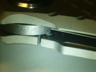

Picture of my engaged framelock. You can see the side of the detent ball here.
Can you spot that slight bronze curve in the pic below? That's the pivot washer (if I am not mistaken).

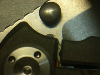

The detent ball. The detent ball is in full contact with the blade tang.
The framelock has been disengaged:
Yes, the detent ball does leave a 'mark' on the tang. The picture below is not that clear, and it looks like a scratch. Actually, it more like a polished surface on my knife with no indentation. Then again my knife is new and has only been opened a few times by me.
Knife is almost fully closed. Notice the small round indentation on the blade for the detent ball to 'fit-in' giving a nice solid lock-up when the blade is closed. The 'line' marks you see in the picture are not scratches! They are actually lubricant/grease that has been smeared. In real-life, the lubricant looks whitish in colour. The picture is deceiving as the lighting is poor.

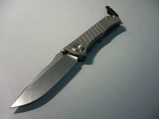

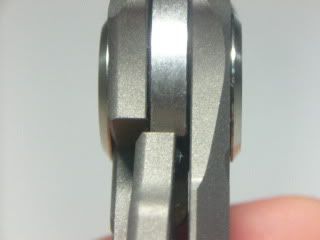

The knife is perfect! My only minor peeve, is that my blade is not PERFECTLY in the center. It's out by like 0.5mm! But that's being anal!
Hope you enjoyed the pictures! Thanks for looking.
Nice knife. The ball is ceramic? Is there any concern that the ball could crack if the knife is snapped open? (I'm sure CR did their R&D on the knife, but it still seems like its possible in theory.)
I think there is a much greater risk (which is still extraordinarily small, if not non-existent) that you'd knock the ball out of the lockbar before you cracked or shattered the ceramic ball. This is the same stuff that is used as armor plates on modern tanks. If it can take direct AP/HE hits, it's good for a knife. :D The Umnu is a very substantial, very well-engineered piece of work from a designer with more than 30 years (I think) in the tool & die and cutlery fields.
To the OP - nice pics. FWIW, I'd say that blade is centered. Framelocks and linerlocks often don't do better than that - a fair percentage don't even do that well. :)

the lockbar will bend in ward toward the knife before there's anywhere near enough pressure to crack the ceramic ball. that's assuming that the blade wouldn't break before the ball cracks. folding knives have many possible modes of failure, but I don't think the ceramic ball cracking is one of them.

I appreciate the pictures. Didn't realize how big the ball was. Basically IMO the bigger the ball the more durable is the wear (in this design). This is due to the assumption that the surface area of a ball increases exponentially compared to first initial contact. Which means contact is improved when it wears.

PS: IMO (again, got lotsa opinion lately...) the thing that would cause a crack in the ceramic ball* is velocity upon impact. The way it is now in the blade methink even with max distance** available the is not enough velocity to shatter/crack this ball. I could be wrong but I'm fairly certain with this. That's why the ball integrity is not my major concern now :)
*(assuming ceramic ball is homogenous and has no distortion of materials)
**(needed to generate speed with constant acceleration (which in turn is generated from the lockbar stiffness which is actually reducing not maintained during movement from disengaged to engaged))

the ball won't crack, it's not really even slamming into the tang of the blade. the ball, although stationary with respect to the lock bar, essentially rolls into place (some people disagree with my language there, replace rolls with slides if so). any extreme force on the ceramic ball would first go into pushing the lock bar inward toward the slab, which takes much less force to do than cracking the ball. i have yet to notice this even happening, so the event of the ball cracking seems even more unlikely.
Ok, well imagine a new Zaan, imagine the contact area.
Then imagine a much much older Zaan. Imagine the contact area then.
Assume the BB "eats into" the tang over time. Being a ball in shape the increase in area (contact area of BB to tang) is not linear in relationship as we gradually increase the depth of how much the BB eats/wears in. This is especially true as we consider larger balls. It's more than a gradual/linear increase over constant rate of wear depth.
Reality is that the rate of wear is more like gradually decreasing over time as the contact area increases and the forces reduce cause the lockbar will in time travel deeper and at a different position (deeper in) the stiffness is less (may not be easily felt but it's definitely the logical assumption).
Sorry if I'm not good with explanations, English is my 2nd language so it's bit wonky. I've been doing lots of analyzing the Zaan cause I'm interested in the design.
