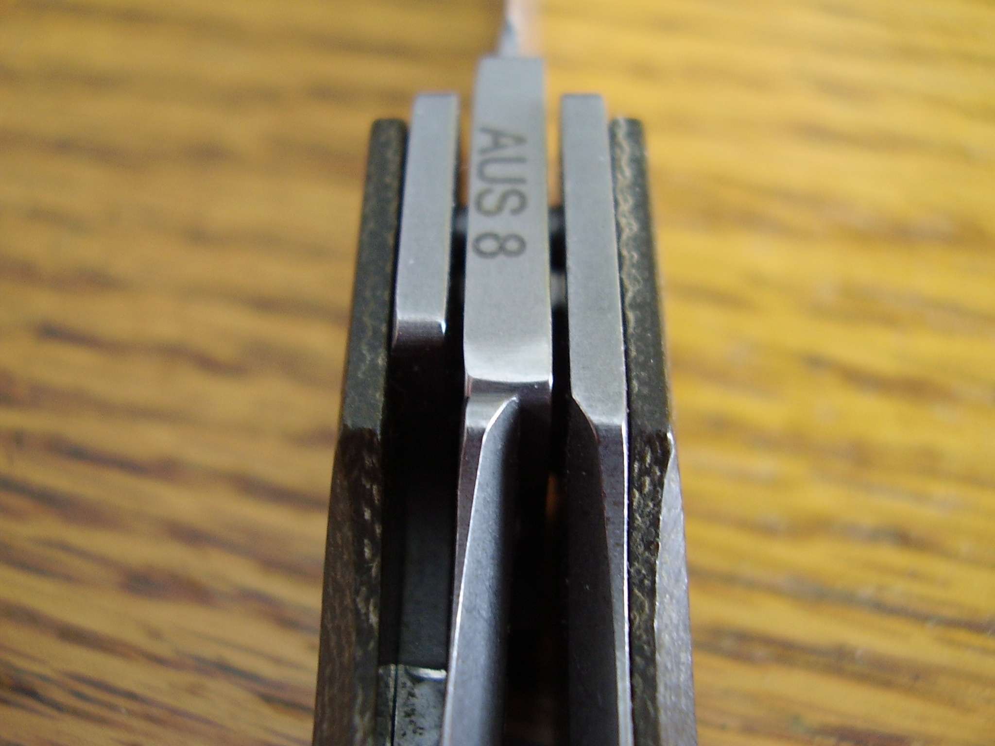

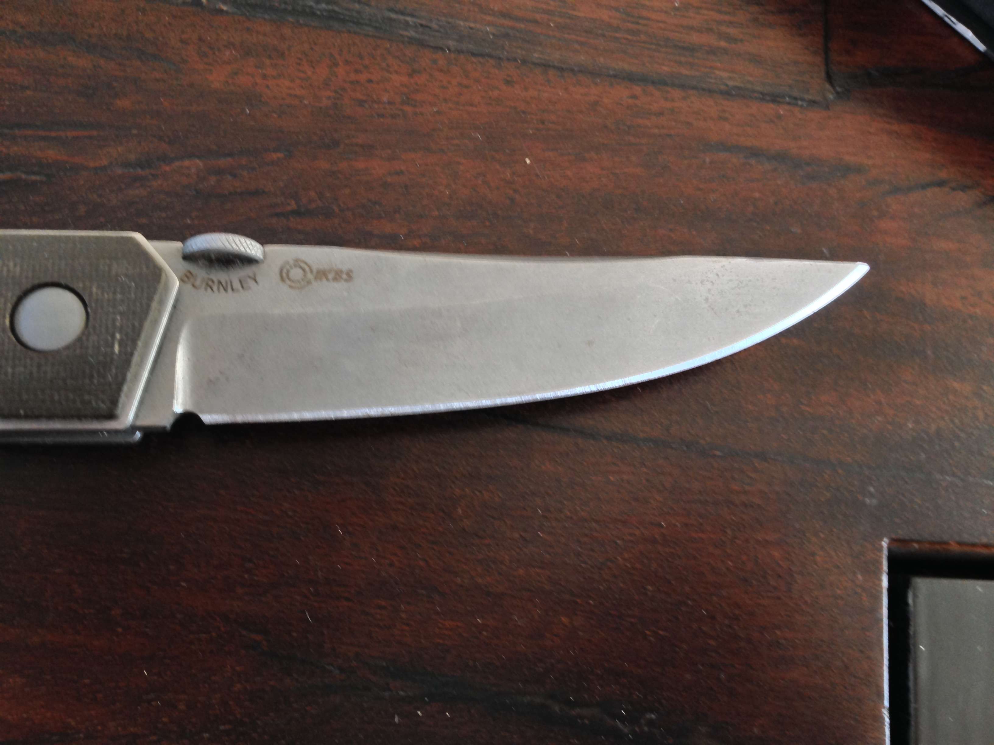

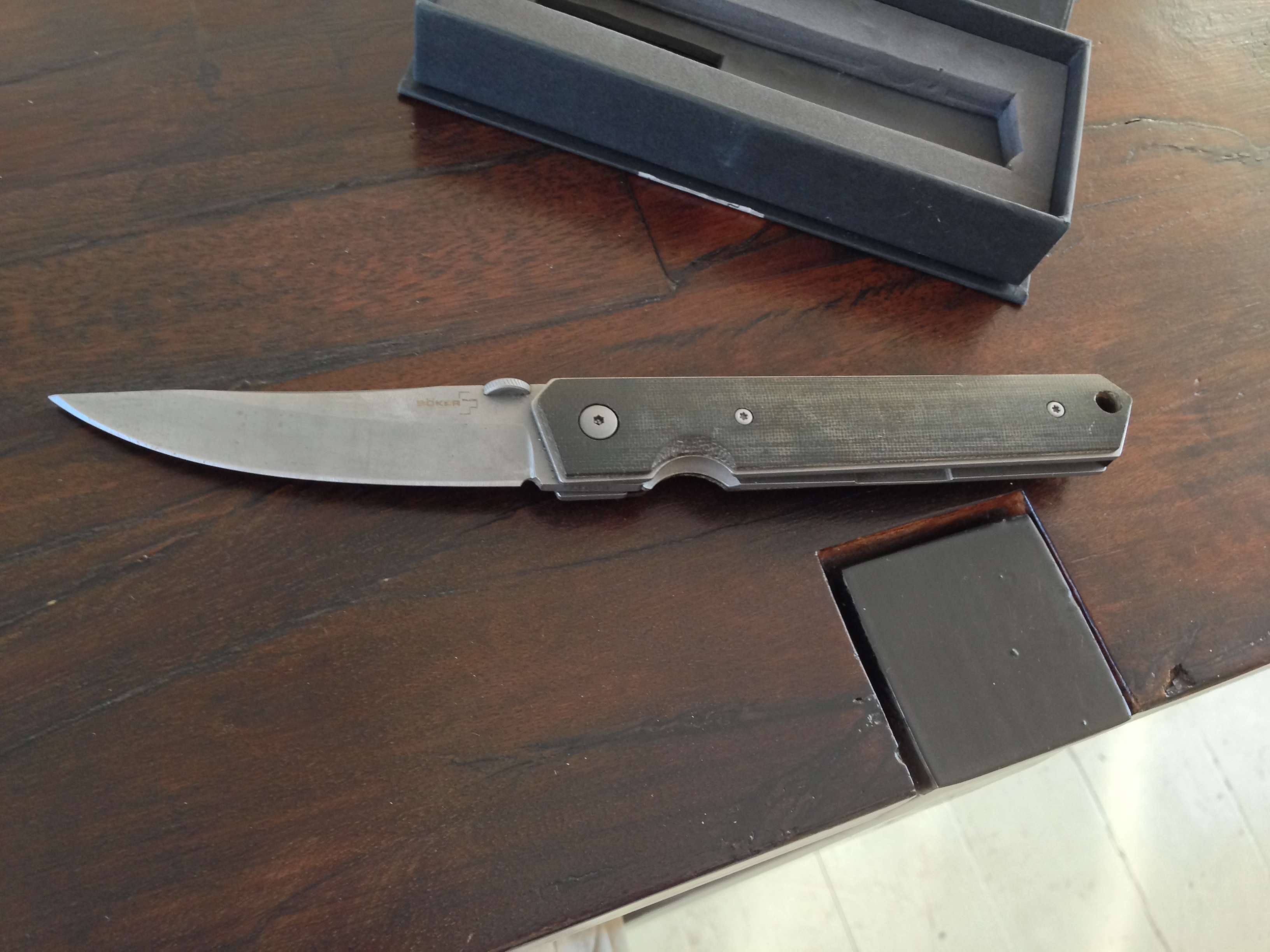

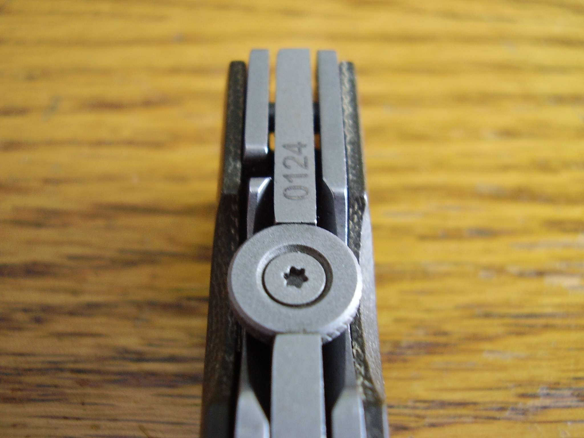

I bought the first release version a few weeks back of the exchange here. Knowing the issues that plagued the first run I was looking forward to trying the "Flipper Mod". To me it was near impossible to use the thumb disk so the mod was just a natural thing to do :thumbup:
Here are some of the sellers pictures (dark wood background) he sent me allowing for some before and after photos showing the difference. The main difference from before and after is the frame near the thumb disk.
After the mod, which in total took me about two hours the blade deployment was a HUGE difference ;)
The lock up was fine prior to the mod but became even earlier after the mod was completed.

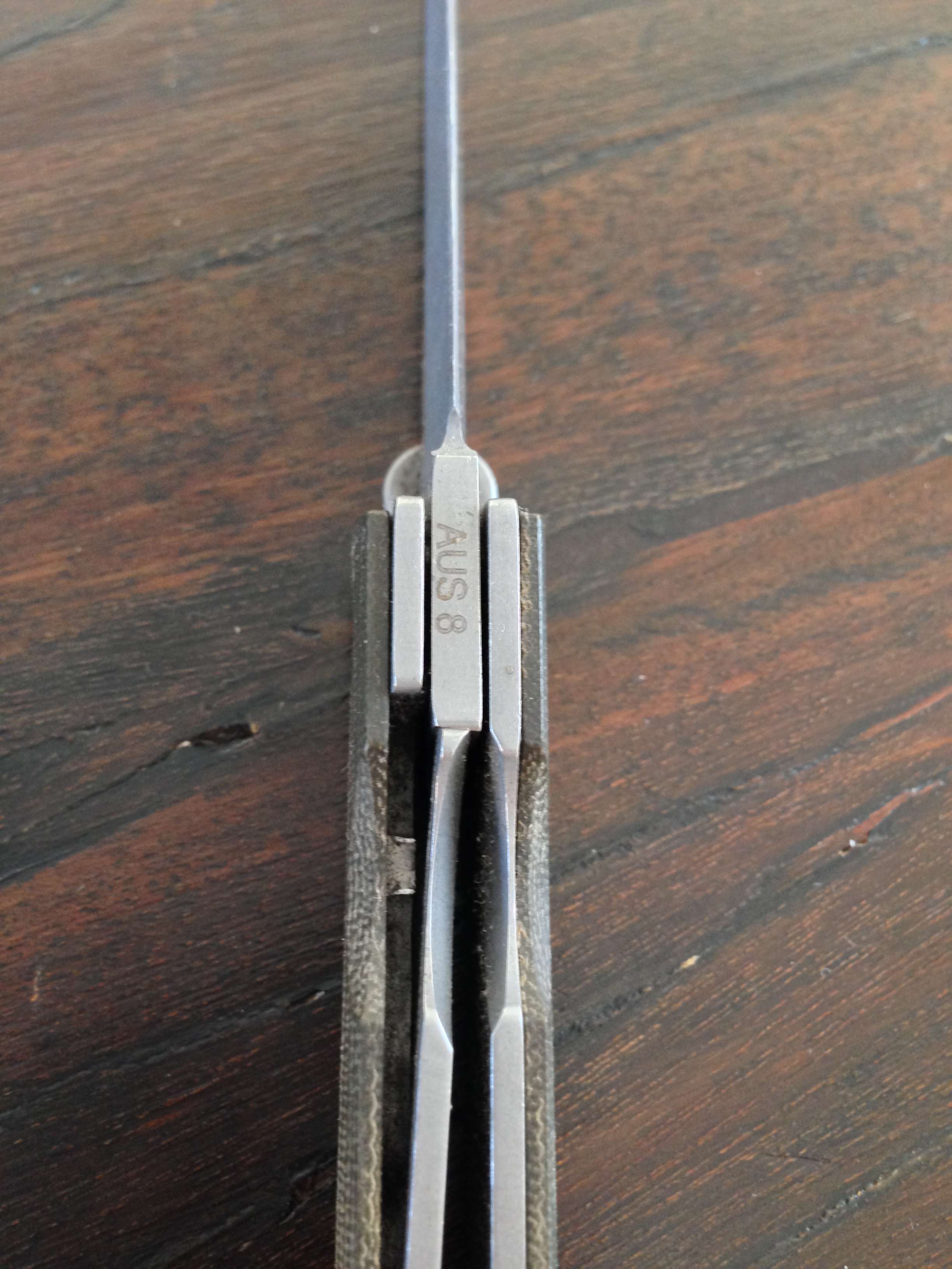

Lock up before...
Lock up after...

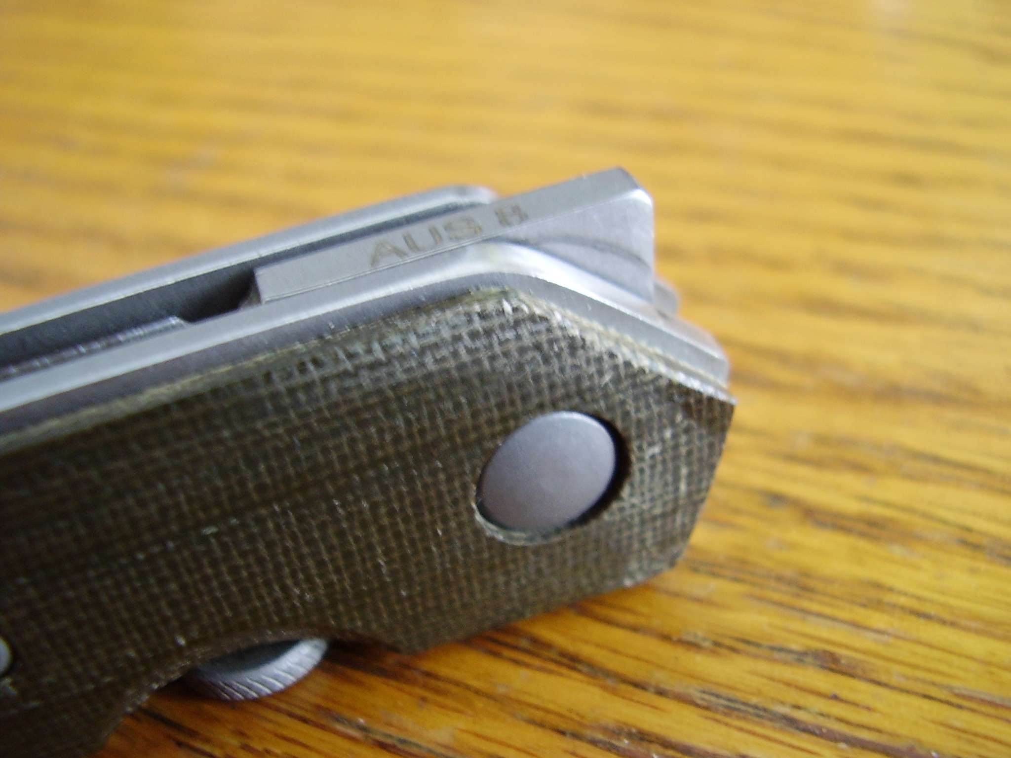

Some additional pic's showing the recess cut up close allowing the base/tang of the blade to be exposed ala the "Flipper" mod...
I wanted to be sure the "Shadow" of the scale versus the frame was as close to factory as possible...overall I was pleased with the final results :thumbup:
Additional pictures of blade centering, which is near perfect...
And, of course the "Serial Number" shot :o
In a "Nut Shell" I love this knife!!! It's slim yet fills the hand. It's one of the easiest to deploy knives I own when it comes to working outdoors with lined leather gloves.
Paul

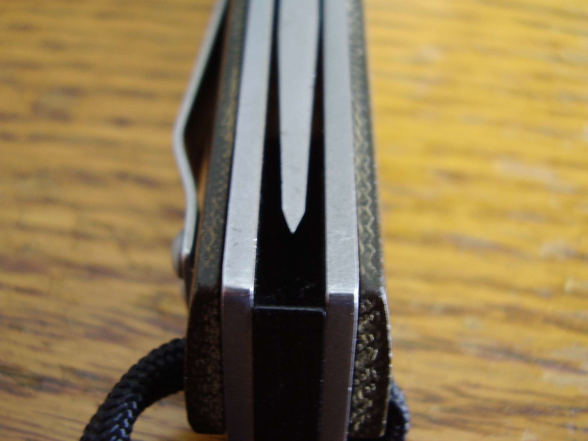

Very nice work, there. Do you have issues with the blade tip nipping your fingers when closed?
As mentioned on other threads, my first one (green micarta) had a bad detent, and I could tap the blade open a couple millimeters. Returned it and bought the orange g10-scaled "Blade HQ" version. Quality was way better on that one, but it still could nip a bit. Was going to flipper mod that knife and address the tip, but once I received the flipper, I knew I had found the best version for me. Everything arrived dare I say perfect on the flipper. Here they were together:
If I had kept and modded the Blade HQ one, I would've done something like this (posted by another member):
It does have the blade nip issue if I purposely drag my finger over it but haven't had it be a day to day issue.
