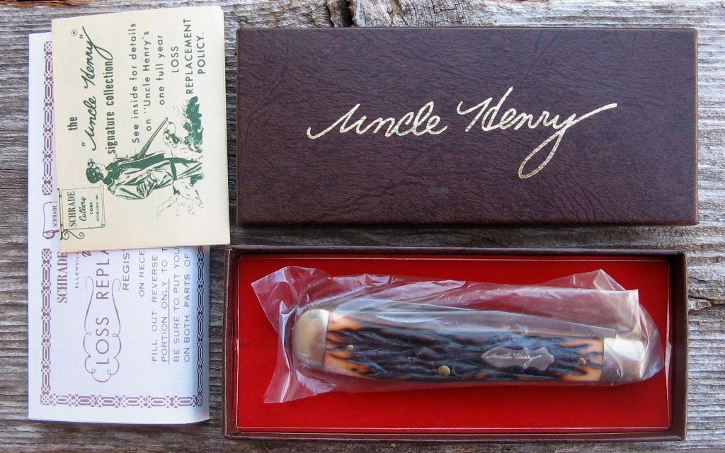

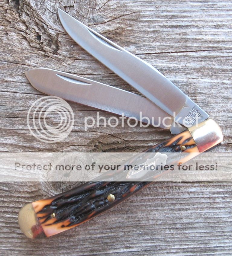

The carbon steel versions continued after 1973 as well. And some of the Schrade Waldens were stainless for sure. I've always found this very topic to hold some intrigue as well as contradiction.
This one does not say stainless or have a SCHRADE+, and the pamplet said High Carbon Tool Steel. Note it also has the razor finished blades, which I would think were more indicative of stainless steel.

Very collectible, and you can find both Schrade Walden and Schrade NY USA versions of the 285UH (as well as the 885UH) with milled liners, and a variety of different stampings too. And don't always count on the catalogs for accuracy either.
