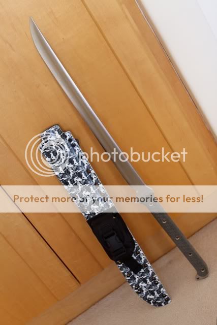

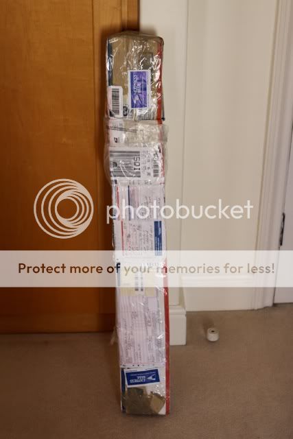

A short story...............
A few years ago Ban worked his magic on a AK47 for me.
When the blade was sent to me there was some screw up with the USPS shipping and it ended up sitting in a depot in Holland for about a week before it wound its way south. Unfortunately the bin it sat in had water in it and when the package arrived much of the cardboard box was soaked through.
I removed the blade from the sheath expecting the worst! Surprise, surprise..........it had a few tiny surface rust marks. Out came the polish and in less than 5 minutes I had restored it to a perfect finish. If that had been O1 or 1095 the blade would have needed a complete refinish.
Now INFI is not stainless and it can rust but I live 50 yards from the South Atlantic and I have yet to have any problems with any of my satin blades.:)
(That AK is still one of my favourite pieces and it cuts like a light sabre!:D)
Steven, interesting story and beautiful blade!
