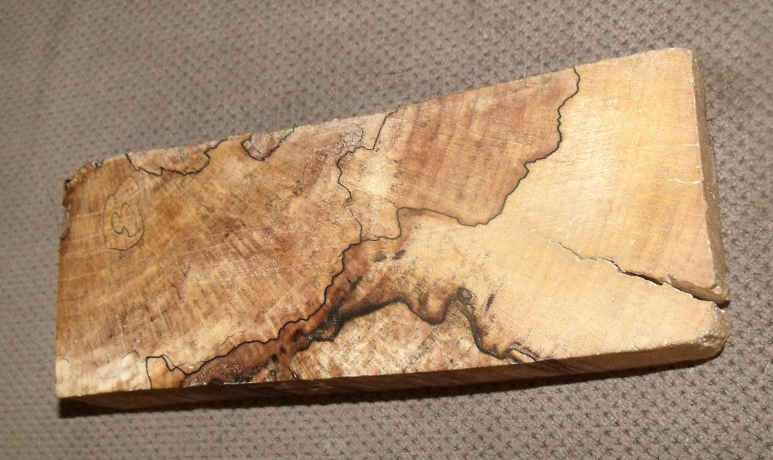

A couple questions about stabilized wood.
First, "Don't try to stabilize spalted wood that has become punky." Is this because it crushes under the pressure when they are forcing the stabilization fluid in? I have a couple pieces of spalted maple burl...never seen it like this before. Not really punky but different. I can sort of press my nail into it. I added a picture. Is this something I can't stabilize? Photo on 2016-01-09 at 11.46 AM.jpg

First, I've used plenty of pieces of wood that look like your pic that were stabilized.
Second, The WHOLE point of Stabilization is to be able to use woods that are punky, soft not ready for prime time.

The piece you showed in the photo will probably stabilize well. After stabilizing the areas like the right portion of the block will have a different texture than that on the left. After sanding the right portion will be more of a satin (duller) look and the other will get shinier. That can usually be evened out by wet sanding with an oil blend like Danish oil or Tru-oil when you finish your handle.
Watch out for the stuff that gets kind of crumbly when you cut and sand it. That tends to change shape and separate causing cracks and voids when the stabilizing solution is cured.

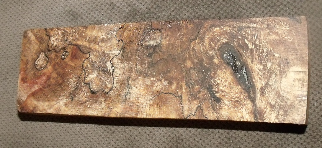

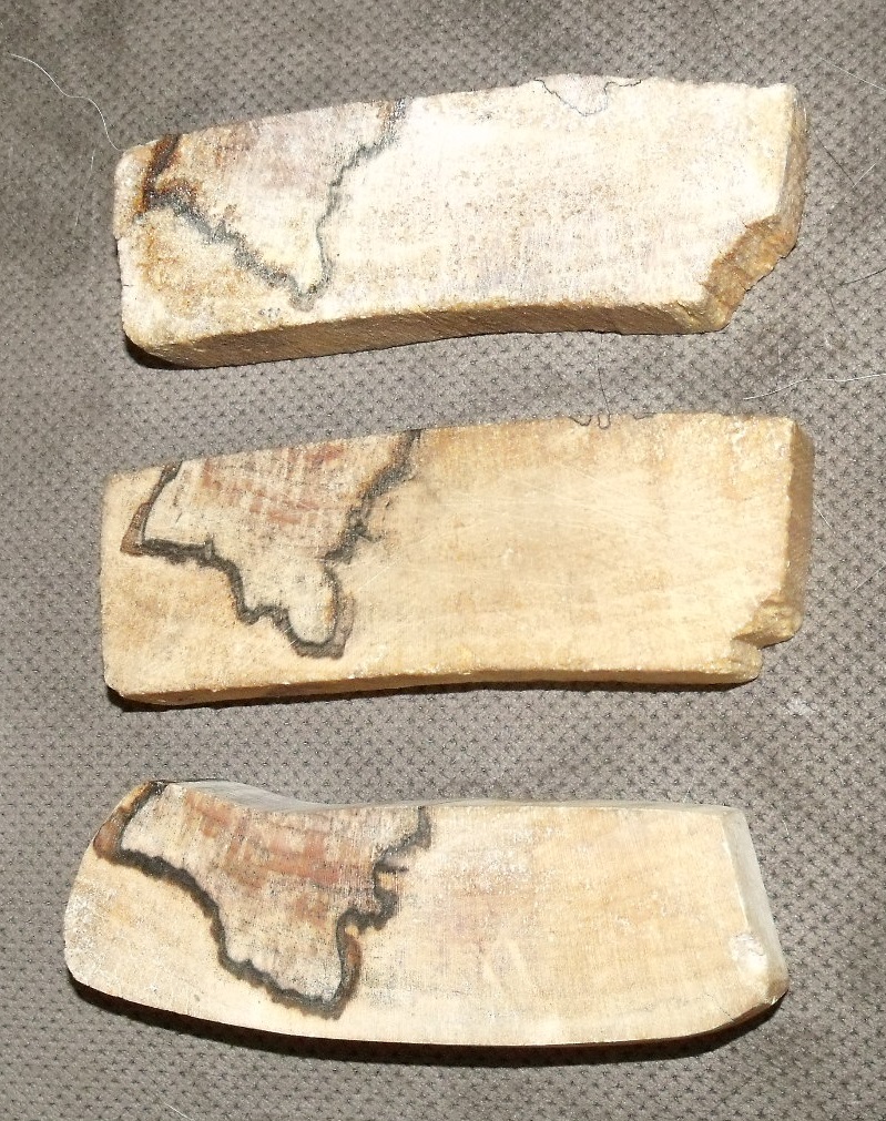

Here's a few examples of some maple that had some punky wood. The first picture shows what can happen to the soft crumbly stuff.
The second picture is a group of pieces where the yellow was punky enough to crush in my fingers but as the bottom piece shows, it shapes and stands up to sanding pretty well.
The third one had some pretty soft areas that did shrink below the surface of the rest, but here it is after a bit on the belt sander and it's getting pretty solid.
So in MHO, punky wood CAN work, but don't be disappointed if it doesn't.
