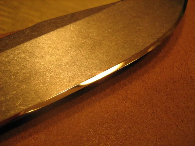

I would choose #3. If you want perfection from the factory you either need to get lucky or spend more money, sadly. I don't like it but I assume all knives will have an uneven edge bevel. It doesn't effect function and it is easily remedied if it really bothers you. If you're obsessive it's hard to beat the calming effect of a perfectly symmetrical, mirrored edge bevel. :D

Good Gowd, Man! Hurry, attain the help of a lawyer, and SUE SPYDERCO!!! Darn company sends you a pocket knife that is shaving sharp, but is IMPERFECT!!!! A mob formed in my city just reading thing, and they're leaving a swath of destruction all the way to Golden, CO! Call the President! Hurry! Time is running out! Your life depends on this choice, and you can't wait for suggestions here! Not enough time! RUN! Rent a plane and go to CO, man! Pound down the CEO's door NOW! This is no joke! I here the simple fact that you have an imperfect bevel is causing us to support rebels in Syria!! I've got to dig my bunker!!!!
The knife works. Use the friggin thing and live with it. Put down the Micrometer and microscope, Poindexter. Holy Carp, I am so tired of this kind of whining. I am glad I just get a knife and ignorantly use it without sending it out for an in depth perfection inspection before enjoying it. Life is easier that way.

Hi guys,
I'm a long time reader, first time poster. I recently got into knives, and bought a Delica 4 a few months ago. It's been a GREAT EDC! However, I found myself looking for a big larger blade with a different lock. I found the blade shape perfect, I just wished that there was a bit more of it and I found myself wanting a finger choil.
As you can tell (from the title of this thread) this led me to a PM2. I was able to get one online and it came in a few days ago. The lockup is SOLID. I do have an issue with the knife though.
I bevel on the knife is very irregular. The knife still came shaving sharp, but the bevel on one side goes up the blade about 2-3mm more than the other side. This is occurring right by the tip. Overall, between this and the fact that the knife appears less smooth than what I've seen in some videos, I'm debating parting ways with it. Also, I have a love/hate relationship with the handle. When it's not in my hand, I think that there is too much of it, but when holding the knife I find the ergonomics perfect.
I'm wondering what I should do. Here are the options I'm considering and I'd love your opinions to sway me one way or the other.
1. Send the knife back, get a refund. Pick up a different model knife, maybe a BM 940?
2. Send the knife to Spyderco and hope they fix it. Honestly, I think the bevel irregularity might just be a function of buying a production knife and I should probably just accept it as is. I don't have high confidence that Spyderco would be able to fix the issue, as I'm fairly certain that this is well within tolerances.
3. Use it and enjoy it. When the blade gets dull, just have it re-profiled to ensure that the bevel is good to go.
Thanks for your input and helping me figure out what to do. I'm strongly leaning towards option 3 since the more I fondle it, the more I love it.

Where is the knife made? If it was made in Japan that's how they do it. Their blades are not 50/50, more like 70/30, and a lot sharper because of that.
