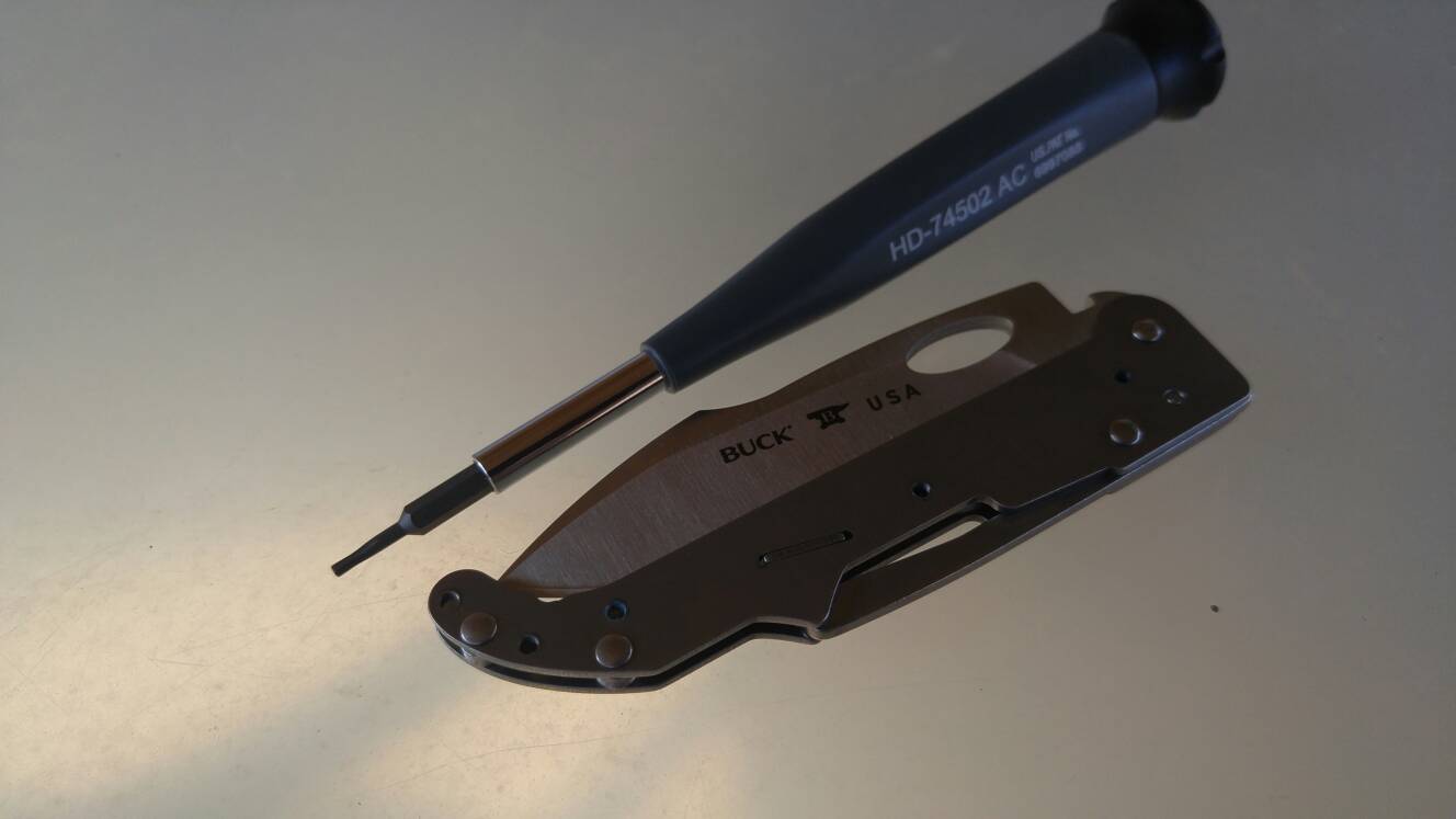

That said i have received 2 examples of the Buck Fluid. The first one had tons of side to side play, the second one had tons of side to side play an up-and-down play. Once I started looking more at the design of the lock and construction my concerns raised in terms of stability of this design and price point.
Hidden under six very tiny handle screws that were coated in blue Loctite but somehow came out with no resistance whatsoever is the pinned construction of the knife. You can see the pin for the lock back is very close to the front of the knife by the pivot pin. With very little force the entire lock wiggles inside of the frn handles.
Yes I understand many lockback knives are designed with pins. However most of the time the lock pin is located halfway down the lock or a little bit further down than it is on this model. The result really looks to be that force is not distributed equally throughout the lock and the frn handles do not have nearly enough strength to hold it in place.
In addition with where the lock is placed in the size of the knife in your hand, with a firm grip at the right angle the lock can easily disengage in your hand unintentionally.

This video shows the lock wiggle I'm describing.

Not trying to doubt you, but the pins on the 284 are a lot closer to the pivot than in the Fluid and yet it does not suffer from any form of play.
