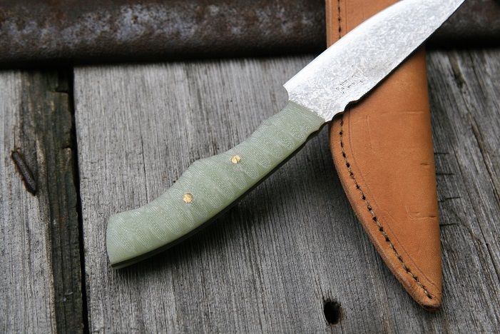

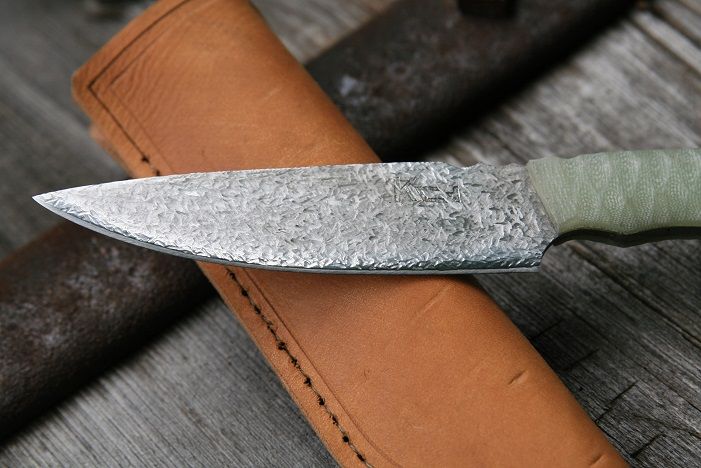

A very unique knife that I just finished up.
photos really don't do this knife justice!
Knife specs:
Steel: 1095
OAL: 9.125"
Blade: 4.5"
Thickness: .125"
Grind: flat with convex cutting edge...Very sharp!
Scales: ghost jade G-10 with anso pattern
Pins: brass
Sheath: butterscotch buffalo hide
Asking SOLD shipped
its on another site so first I'll take it, gets it!
thanks Morgan

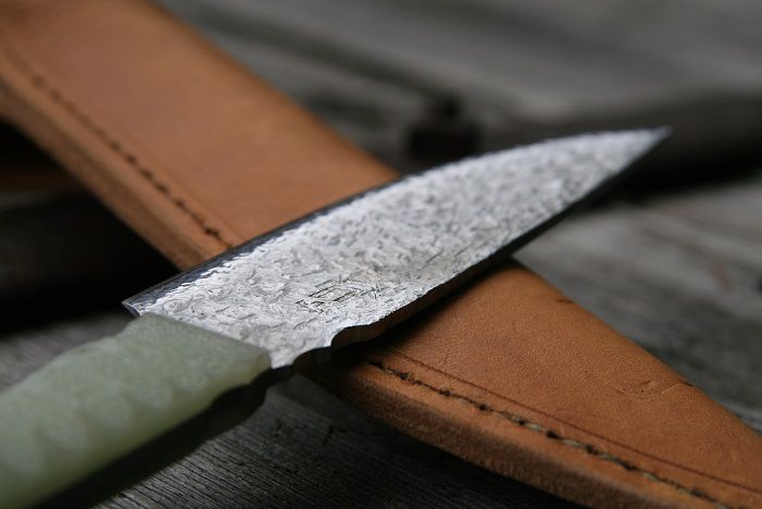

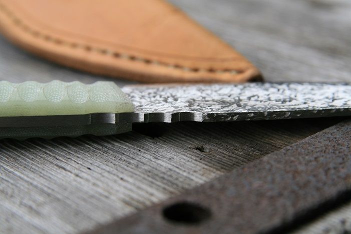

Could you describe the textured finish? Is it hammered? Very interested.
I was trying to go for a galvanized look, I do it by hand with my dremel tool and a cut-off disk... it takes a while but gives a real interesting look, it sparkles when it hits light, unfortunately the pitcures don't capture it that well, it a bunch of tiny divots.
hope that helps
Morgan
Very nice, I keep going back to look at it. I like when makers try new thing. You pulled it off well.
