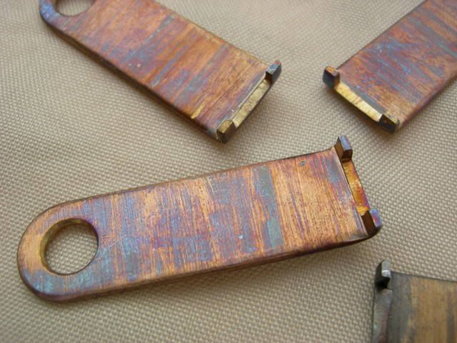

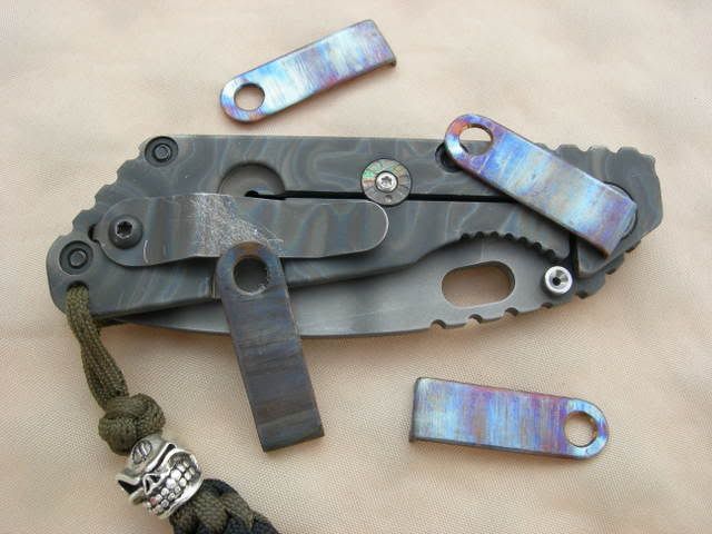

I just ordered one of these from a guy on the badlands forum. (bad link, see below post for pics)
very inexpensive compared to a lot of the alternatives.
give me a minute, I'll get some pics up
they are 1.5mm brushed and flamed stainless steel
I hope I don't get dinged for spamming, I don't know the guy personally or get anything from showing his tools. I was on the hunt for something like this the other day and I'm just trying to help out J's Knives-N-More
