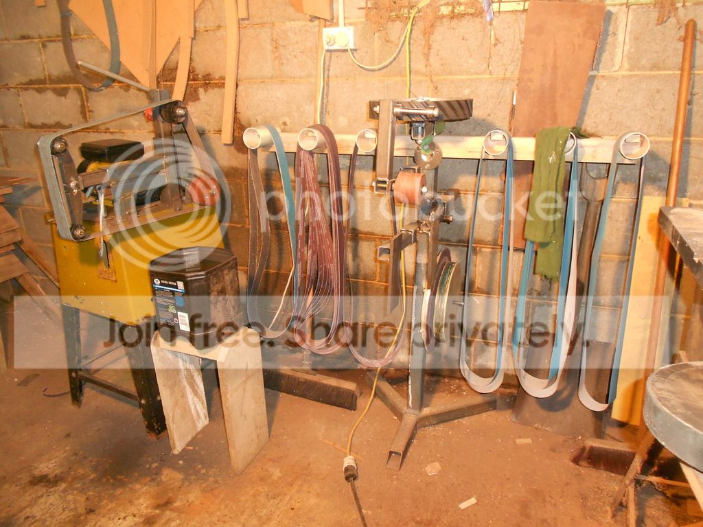

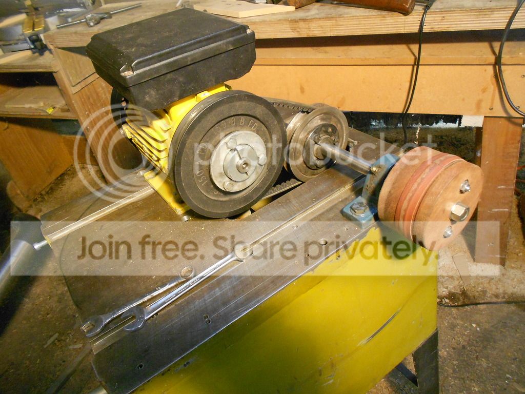

Up and running -- Video added

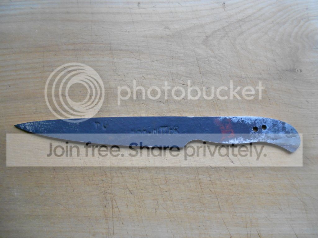

The first grinding done was to do a chisel grind on a 5 inch bladed salami knife I had profiled when the previous motor was installed. The steel for this one is/was a large swedish mechanical hacksaw blade so I have done it in the hardened state. Unfortunately I tore the tips off my only carbide tipped drill bit so will have to put this one asside till I get some more. I have ordered some cobalt bits but they will be a couple of weeks away .
In the meantime I have made a start on a general purpose farm knife and a skinner I have been asked to do.

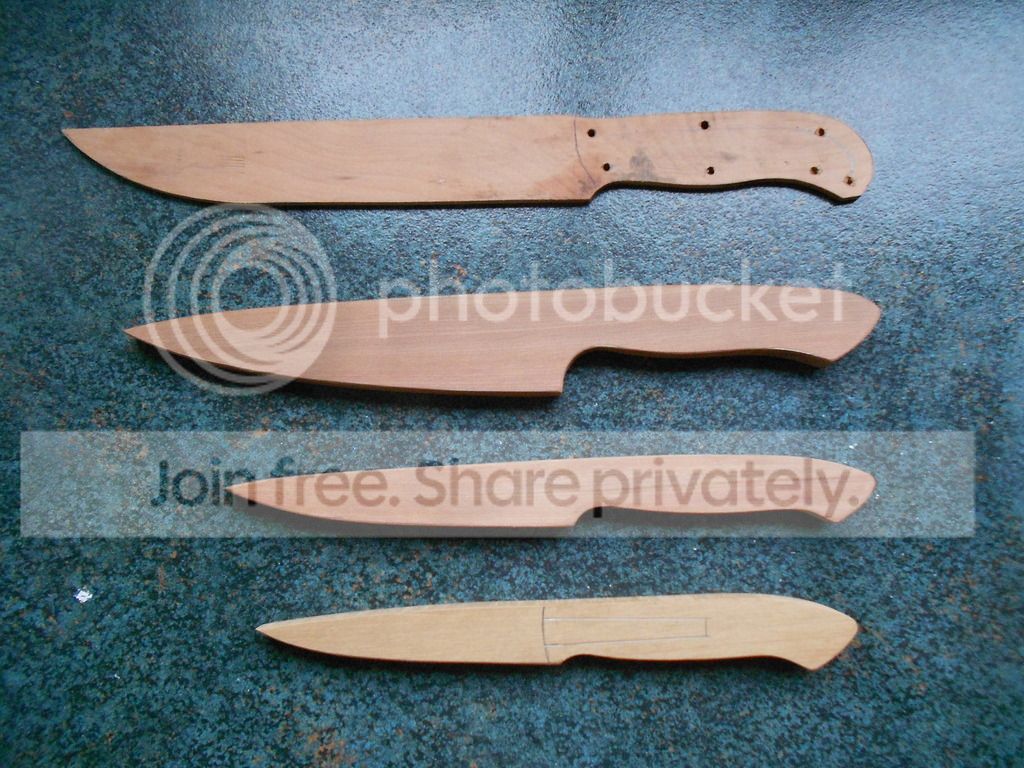

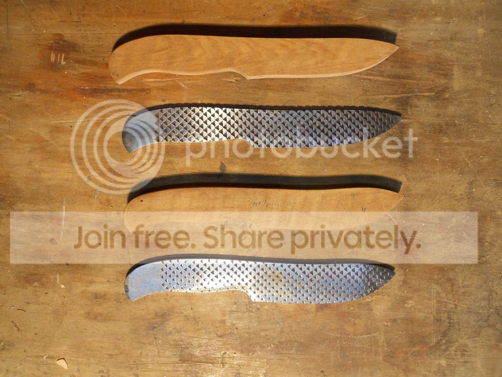

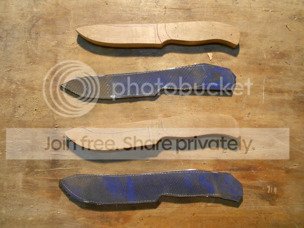

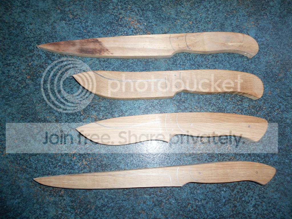

This is my set of patterns. I do them in wood first to make sure they will "feel" right in hand but will eventually transfer them to a better medium
A steaking knife, Kitchen slicer, my salami knife and a paring knife

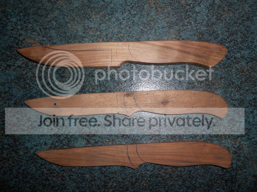

A slaughtermans knife, 2 different skinners and a boning knife
2 hunters and a boys knife. I didn't have the general purpose farm knife pattern in this group as it was away to check the size/fit with the guy I am doing the knife for.

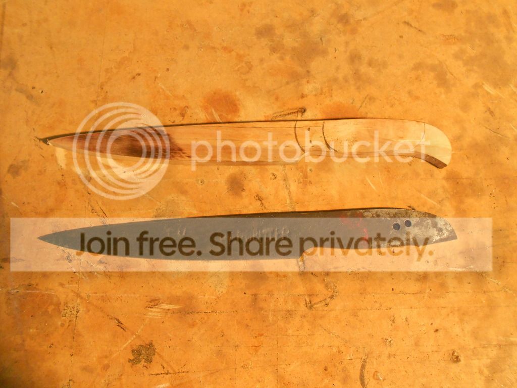

I made the slaughtermans knife on my small grinder while I was waiting for the 2x72 to be finished. I have a few sheep and need to kill a few each year for the freezer so I needed one for myself which was a good way to make sure the design was right but as it was modelled after the lion knife which was in fact a 19th century English design http://www.africahunting.com/threads/the-lion-knife.28385/

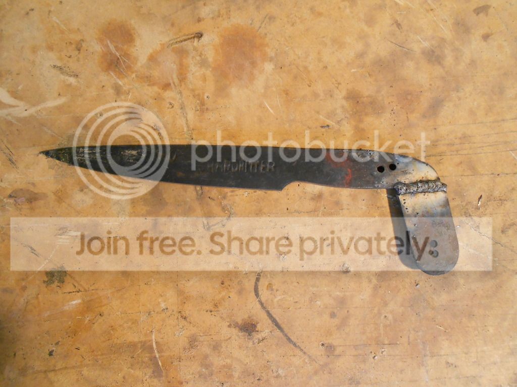

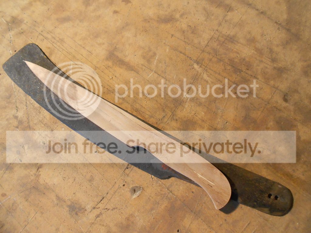

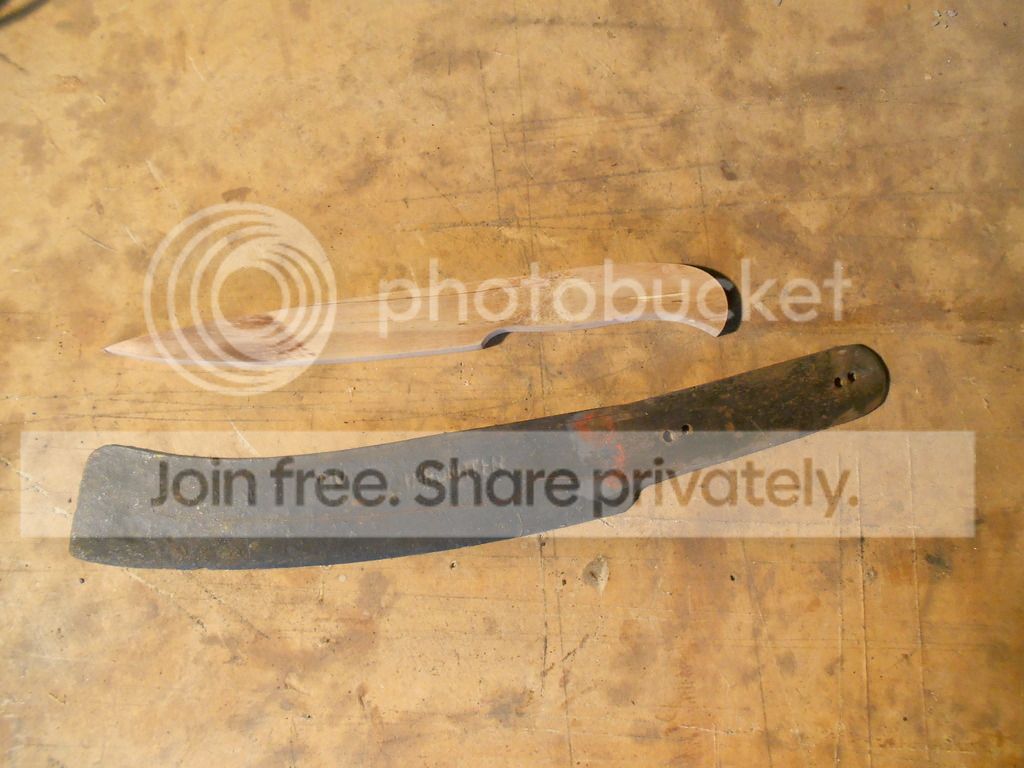

I used an old slasher for this one
It was not going to be large enough to get the full pattern from but I figured I could make it work.
With a bit welded on to fill out the pattern

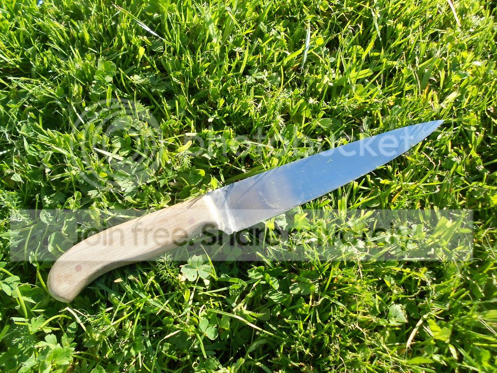

A bit more grinding and it was all set to go
I have finished up with a knife I feel will be about as good as can be got to do the job I have to do with it.
