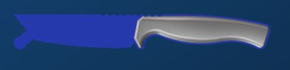

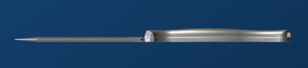

This one is not out yet but ready for heat treat. I'm gonna target around a $200 price point maybe a touch less.
.156" AEBL and fully cnc machined.
For once I did not design the blade! An employee of mine we will call Josh did the initial concept as he wanted to learn the CAD software and 3D printing. After a handful of revisions everyone in the shop was impressed with the overall size and feel of the 3D print so we decided to roll with it.
We wanted thinner edge geometry so we used a "tab" at the front of the knife instead of ultra low profile toe clamps. In some ways it complicates the machining and in other ways makes it easier.
