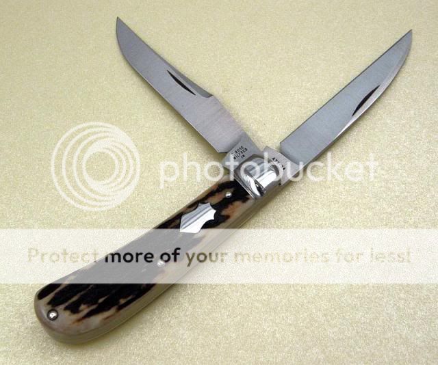

A description of the 2012 forum knife (sorry I didn't do this sooner):
2012 Bladeforums Knife
Pattern: Curved Jack/Trapper (see attached photo titled curvedjack.jpg)
Size: 3-5/8" - 3-7/8"
Blades: Wharncliffe Primary behind a Turkish Clip Primary, half stops on both blades
Nail Nicks: Standard, both on shield side (placed so blades do not interfere with nicks)
Blade Steel: 1095 carbon
Blade Finish: Satin, Swedges on both blades, no etch, no serial numbers
Bolster and Liner Material: Nickel Silver
Blade Tangs: Must accomodate Bladeforums Tang Stamp (one pip must be removed so that there are 8 left - to be provided), "2012" tang stamp
Bolster Style: Rattail (one thick groove), Bareheaded (bolster only on pivot end - none on non-pivot end)
Scale Material & Color: Bone (see attached photo titled Bone.jpg for COLOR ONLY!!!! - GEC calls this "Green Tea Stained")
Scale Finish: Jigged as shown in attached photo titled jigging.jpg
Shield: "Sharp" Bomb (see attached photo titled sharpbomb.jpg) - must be pinned
Delivery: By November 9

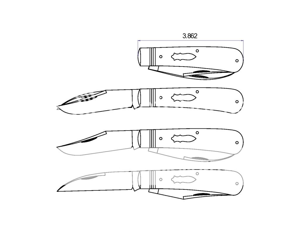

And here's the line drawing of GEC's interpretation:

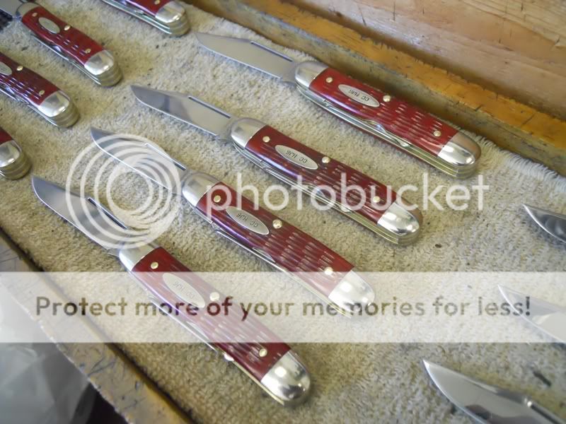

GEC's picture
