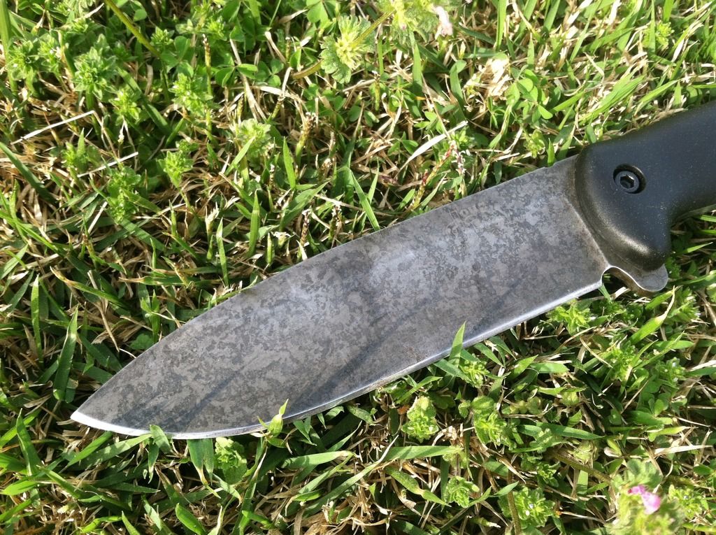

But dude, seriously, that looks unreal! Awesome work bud. Yours also looks machined now. Fantastic! You guys rock!
Turned out great, you wanna sell it?![]()
Deal!Thanks coldone!
Hah, I haven't even had it a week yet. If things get tight you'll be the first to know!
Just to expound a bit ...I measured and marked the blade. Then used a small triangle diamond file to score the center line of each jimp. Then the edge of a small flat diamond file, then a small round diamond file. As each jimp got progressively larger and deeper, I constantly remeasured to insure each cut was still centered. Finally, I switched to a 3/16" round chainsaw sharpening file to complete each jimp. Just take your time and let your OCD take over.![]()
Man, I had forgotten all about this 12. Again, awesome job man. One of the best looking 12's out there. :thumbup:
Does the 12 seem 'sliceyer' than the 10 or others . I wish it was a full flat grind. guess its pretty close
Wow, thanks Dubs! Been loving it! A bit of an update, started on the jimping but haven't picked up the right size file yet to complete it.
