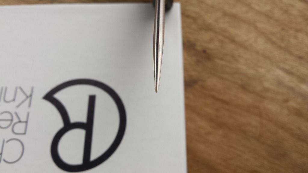

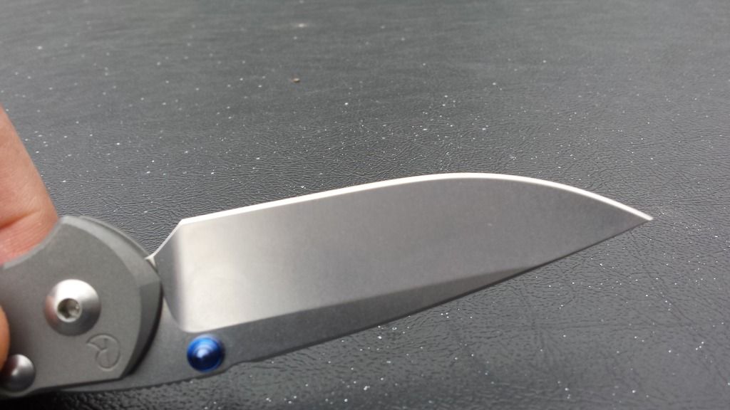

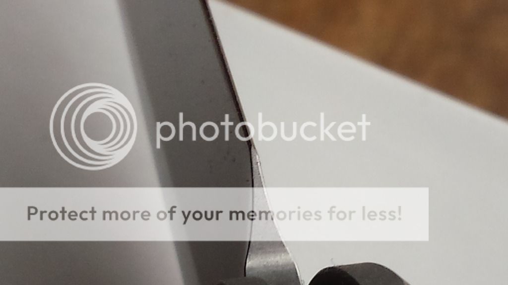

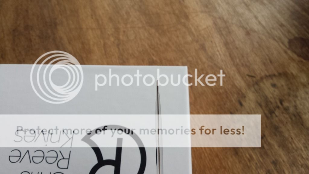

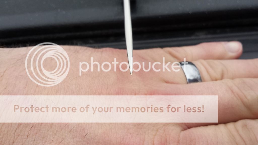

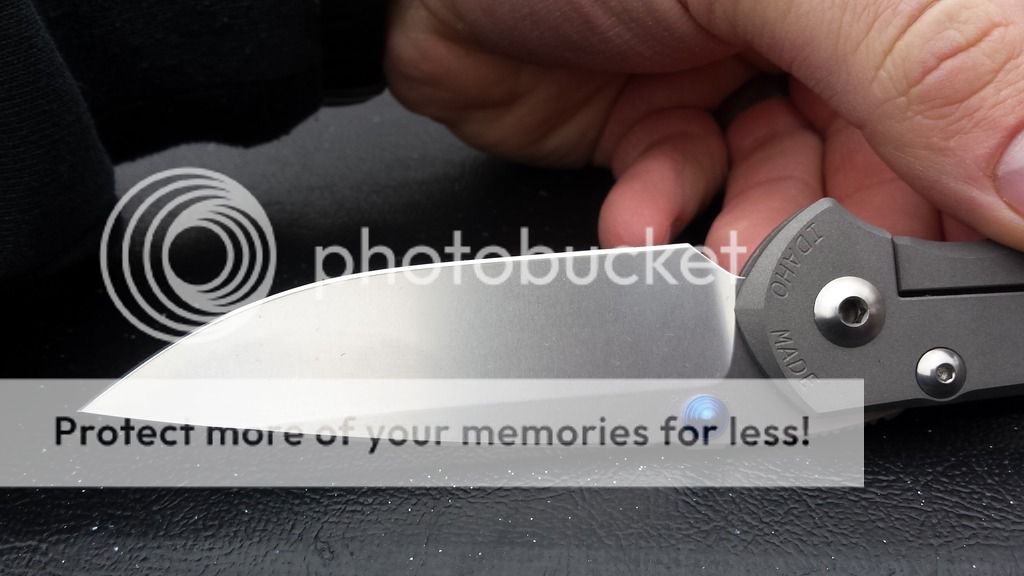

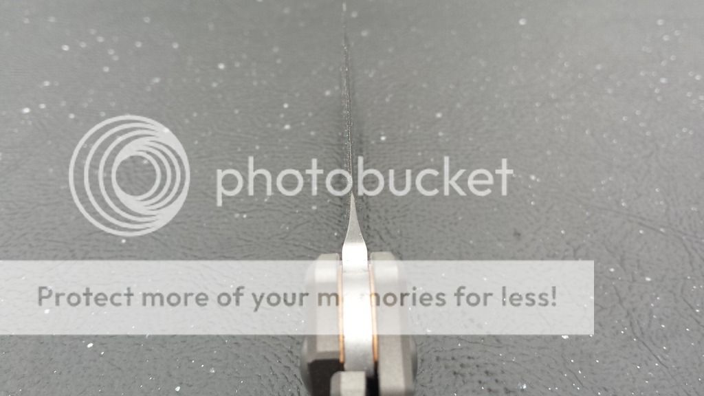

Heres where I need some advice/opinions/help......... Last night I looked over the blade with a closer eye, and it has one of the worst blade grinds I have ever had on a knife. One side is perfectly ground, and its like they forgot to make another pass on the other to even it out.
So I slept on it, not sure what to do. I certainly cannot return it to KA after being in my pocket for 5-6 hours. Although it has not been used for a single thing, to me this thing is considered used because the pocket clip now has a noticable sign of being in my pocket.
So this morning, I went outside to get in some better lighting and look over the blade. I was able to take some pictures, while not the best quality, you can clearly see what I have here.
And I did not notice this until now, but you can actually see some heat discoloration on the tip of the blade in person and in the one photo.
Not sure what to do at this point. Im guessing that most of you will tell me to contact CRK and/or send it in to them.
Im just really really bummed and dont want to be without it for a month, and now thinking that I may have made a mistake getting rid of two perfect examples of CRK's for this.
Here are the photos. Please let me know what you think. As of right now, I am not carrying it. Its sitting in the box.
I would have to agree that the grinds look a bit off; it's not just you.
Contact either KA or CRK. I'm sure either one will gladly take care of you.

Its worse in Person. Im not a picky person that picks knives apart either. Hell, the day I get a knife, I usually put it through hell and back.
Im more concerned with the Tip that has some heat discoloration on it from the grind. Im wondering if it had any efect on the RC of the blade in that area.

A minute on a belt grinder at CRK would fix it. I don't think it would be gone that long since it's a minor repair (for them).

That's an ugly grind for sure....
It happens man, humans make mistakes.
Send it in, and I am sure it will come back perfect.
Even the best production methods with the best QC will let a few slip by....

Not a good grind. I'd call CRK and ask them what to do. They want to help. I don't think it'll end up as a big thing.

Really hard to take pictures to show what I mean here.
Yo I have the same discolouration on my Inkosi tip. They heated it up while grinding and burned the steel. It is like a tiny bit of bronze colour. Now if this took place on the edge I would be freaking out and sending the knife in. This is because discolouration from burning means the heat might have screwed up the temper of the knife. However since it is only a tiny bit on the spine i don't mind since I don't need the spine to hold an edge. For now I just tell myself it's differentially heat treated.

I have a large 21 micarta wirh same grind issue but for me not a big deal since i own a Wicked Edge and can reprofile. If you have a similar system i would recommed the same.
Otherwise send it to CRK
This is a very easy fix. Just send to CRK with a note, and they'll fix you up no problem.
I'm sure your turn-around-time will be quick, since the problem with the knife originated on their end. Should be no return shipping charge either if they understand the issue.
Send it in or fix it yourself.
