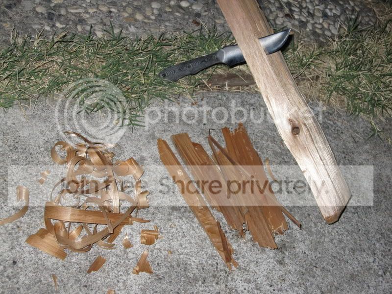

*Small update*
Yesterday I had a couple hours to grind so I started working on my general utility knife. The plunge line and convex grind came out good and I had a real hard time with the tip but it worked out in the end. This is my best job I've done so far and I can see the improvement from my last couple grinds. It's a lot of fun and I'm learning a lot.
I have to share the camera so this is the best quality picture I could get out of my webcam.
Once it's all done, I think it'll be a good bush knife.
