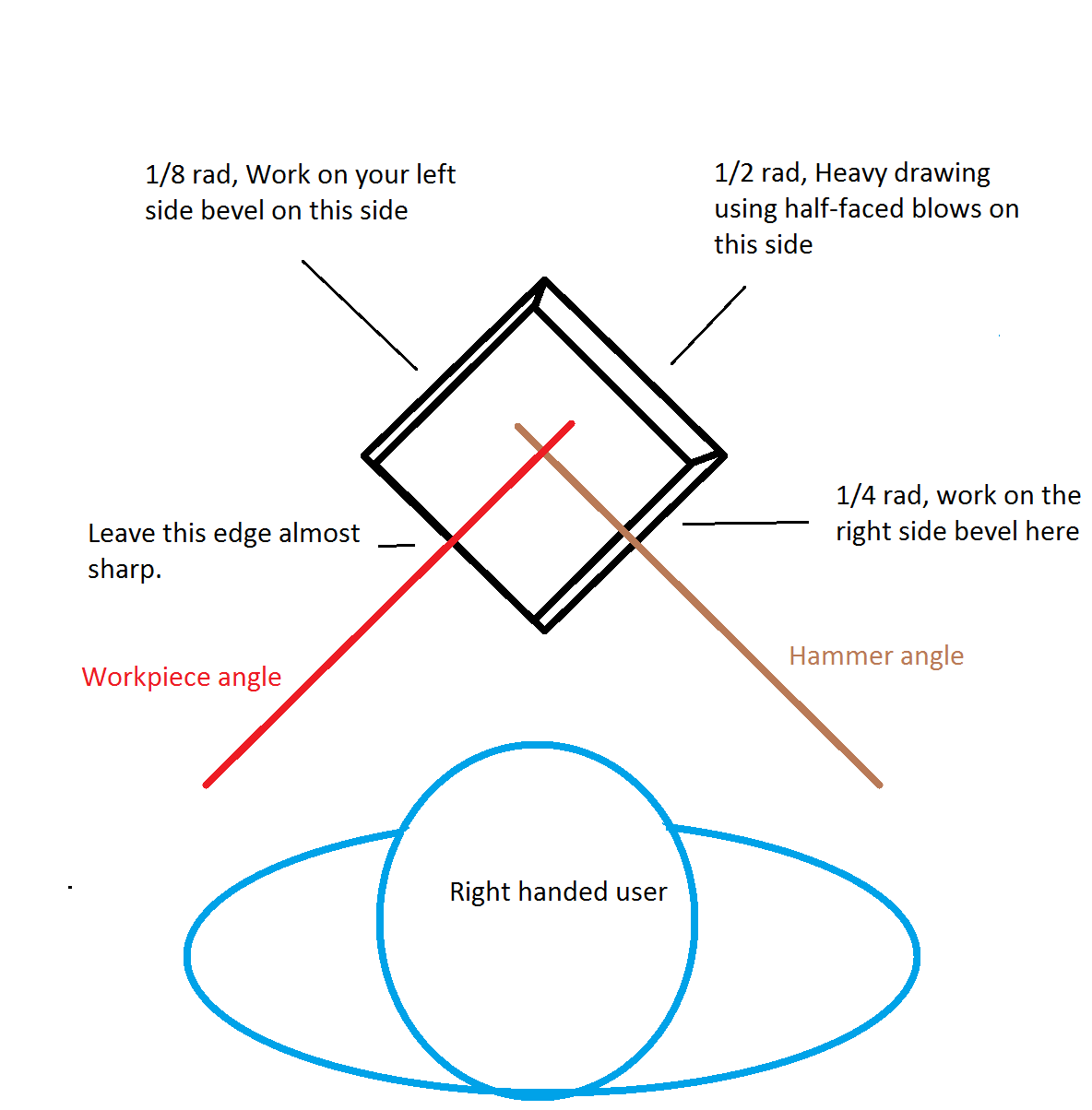

I have been kicking around the idea of doming one side of this OWA to use like a drawing die and flip it over for flat work. I wouldn’t be able to concrete it in, but I’m thinking the sand will stabilize it enough.
Something like this
Eh that would kinda be a PITA after a while. Have you thought about a guillotine tool? The length of the anvil is my concern. Having that 9-12 inches is nice for making sure everything is flat

Looks good. It is almost impossible to use a higher anvil with the knuckles down grip... that certainly would force you to contort your wrist and strain the forearm. I wouldn't completely dismiss it, though. In fact, because you have your Fisher, I would practice with the higher face while using the grip that suits it. Go slow with a light hammer... maybe 2-2.5lbs. Stand at a 45 to the face, keep your palm down and stand up straight.
Here is a horrible drawing... lol.
For reference... I distinguish Right/Left side by holding the knife edge down, pointing away from me
