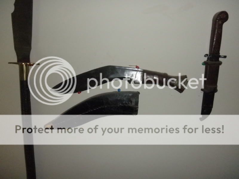

Excellent! I've had a khuk for a couple years now that I got as a gift. Was told it was WWII era, possibly an actual issued khuk there. From your pictures up there it looks to me to be a Mk3.
