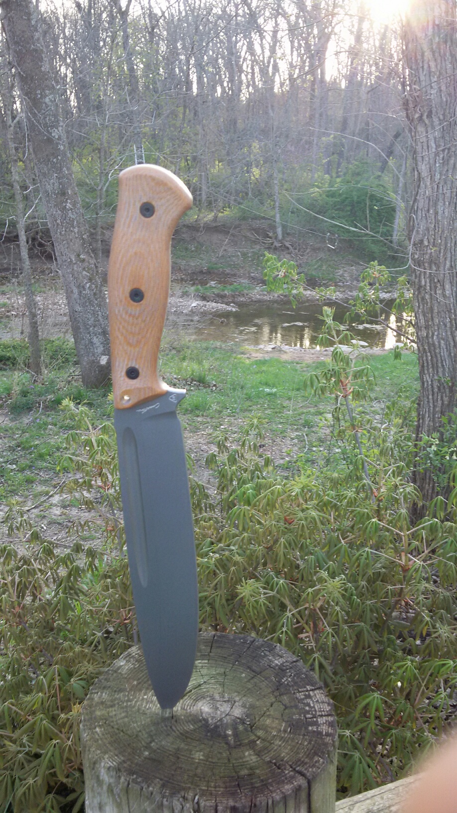

Light Chopper Specs:
CPM 3V, 60.5 HRC, .188” thick at ricasso
Total length 15.625”
Blade length 9.875”
Edge is sharpened 20 DPS
Weight 17.1 oz
Grippy 3D machined scales in micarta

Picking this knife up out of the box, the first impression is of the handle… It feels better then great. All handles hopefully are functional. And some are purpose designed for various tasks. This one obviously has been. I don’t know how a person goes about working up a design and refining it, but this one shows a lot of thought and testing went into it.
It feels thicker at the heel then the front, and as such is designed as a chopper style handle. And it works. Swinging it feels controlled and forceful. The weight feels perfect. For the backpacking and camp trips, this one feels like it will pack “light”. I carried my Condor Hudson Bay in one hand, and the light chopper in the other, and the Hudson Bay felt heavier fairly quickly. I have been carrying the Hudson Bay for camp trips some after thinned and refined the edge. So that was my point of reference today as we were hiking.
The thickness behind the edge on my calipers shows about 0.32. The tumbled finish is flawless, and the fit and finish are perfect. Mine is the buffed Micarta and it is nicely done. I have never found a time when this finish does not perform well. My field knife by Nathan has the same handle, and it always works very well in wet and greasy conditions. :thumbup:

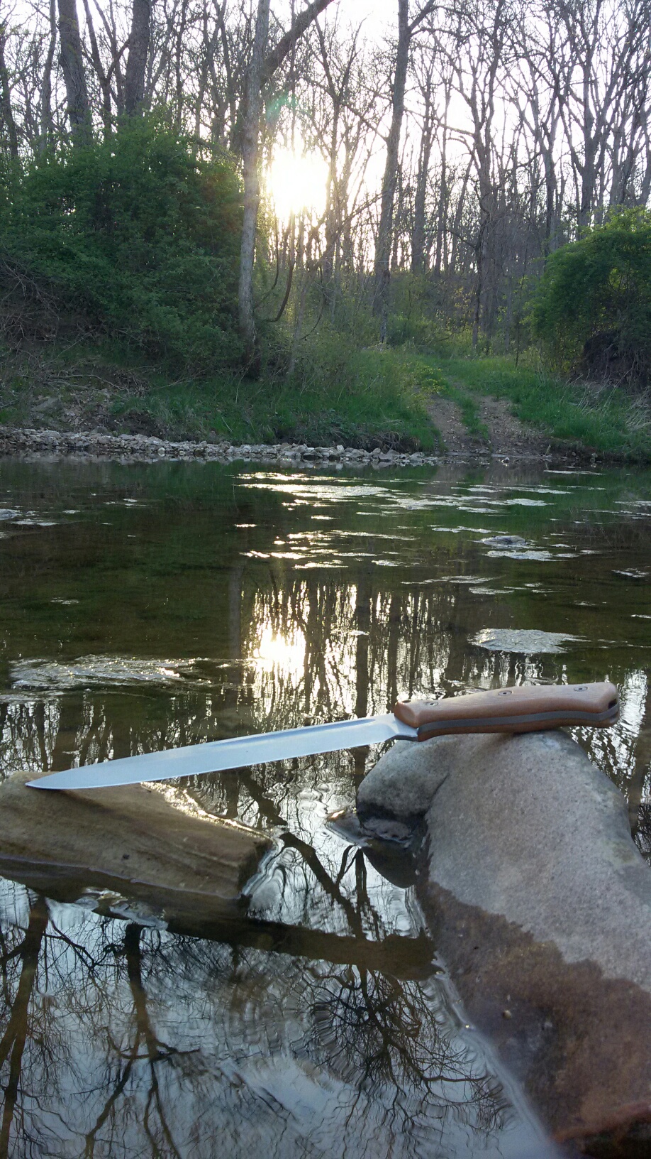

I have included a few pics as the adventure began… It’s spring in the Ozarks. Enjoy… :)

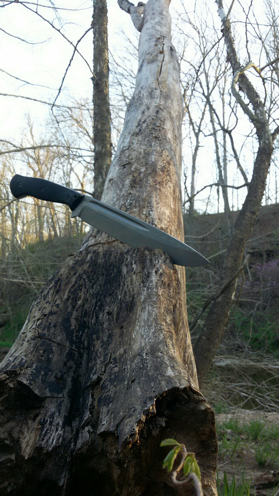

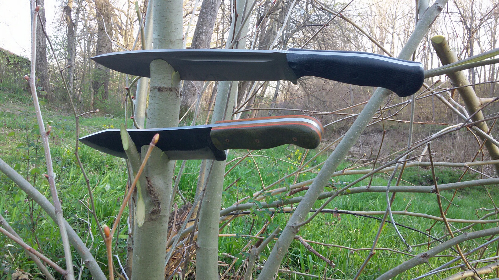

Bite depth compared to my Customized Hudson Bay camp knife... 1 swing

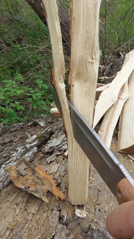

It is growing on me more and more as I “get the feel” of it. This time I did not get to start on my new shelter lean-to as I had wanted to. Hopefully next week. This weekend I used it for a number of tasks. It’s just a way of de-stressing and enjoying the outdoors and researching. The weather is beautiful in central Missouri. Mid 60’s and partly sunny. The gobblers are sounding off and the hens are visible in the fields and lanes. The boys love the chance to go along.

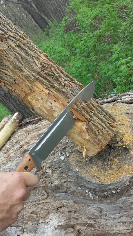

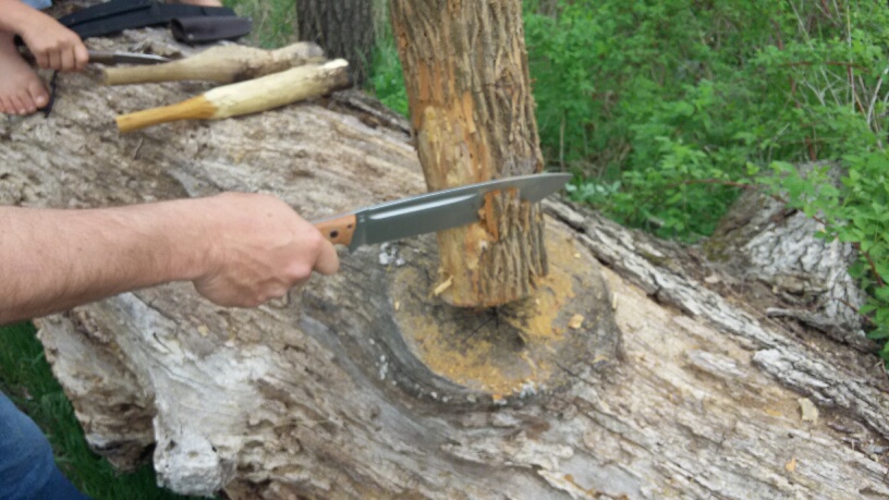

I am starting a new “axe baton” out of this Hedge (Osage Orange) log. And so I started the chopping and reducing on the handle end with this tool just to see how it works. It will be a heavier longer version of the 2 small batons pictured. I usually use one of my hand axes for this type of wood shaping work. I will try to remember to show you once it’s finished.
Notice the pretty colors and markings under the bark on the Hedge pc where the bugs ate the exterior sap wood, but left the inner wood untouched.
I used it as a draw knife to shave some bark and soft wood off of the outside also.

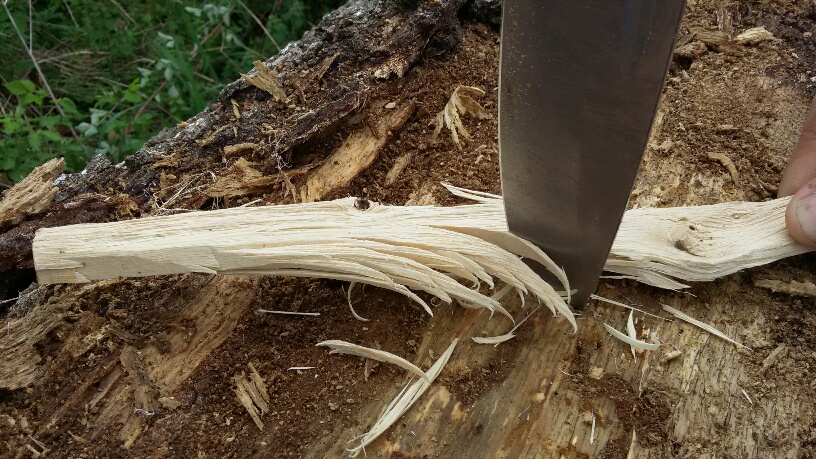

Then I worked down a pc of semi seasoned oak for a “1 stick fire” and made some feather sticks. The choil is small and my finger does not fit totally. But I found the chocking up to help a little for the fine whittling for the feather sticks.
As a static draw knife, the belly edge angle was fun to watch it shave various types of hardwood into curls and fuzz. I was shaping some of the “planks” flat like for camp plates or card tables. It works well for that. The geometry of the edge is such that it bites and cuts with much less effort going into the wood then I am used to with most “heavy” camp knives or chopper type knives.

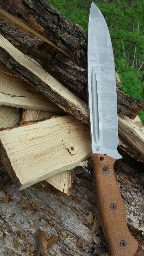

I'm not understanding why a fuller on a chopper? I would think that the added weight (without fuller) although little, would just make it chop better?
Fuller's like this don't reduce much weight but are great to dial in the balance when making a knife.
On a pure chopper whose only function is to chop there is little purpose to a fuller. But on a balanced functional knife intended to be carried on a hike or used at camp weight and balance is also an issue. Weight towards the tip is helpful (obviously) and weight towards the end of the tang is also helpful because it maintains rotational inertia and helps balance the piece. Weight near the center doesn't do much because an impact on one end simply rotates around the center of percussion so mass towards the center isn't very functional. That weight isn't "pulling its weight". For a piece intended to be light and easy to carry any weight in an area that isn't doing much of anything should be minimized. This is done by narrowing the width of the blade, the thickness of the blade, narrowing the grind and if you're set up to mill you can remove unnecessary bulk with a fuller. Blades have been done this way for this purpose for a long time.
The goal with this piece was a relatively large moment of inertia, optimized cutting geometry in bevel thickness and angle with minimal weight. It's a light chopper designed to hit above its weight. It weighs only 17 ounces and a large functional fuller in that location was a relatively simple low-hanging-fruit part of getting there with no real down side to it. I specifically wanted this thing to not be a turd.
