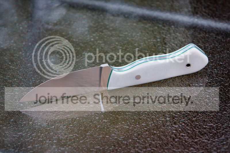

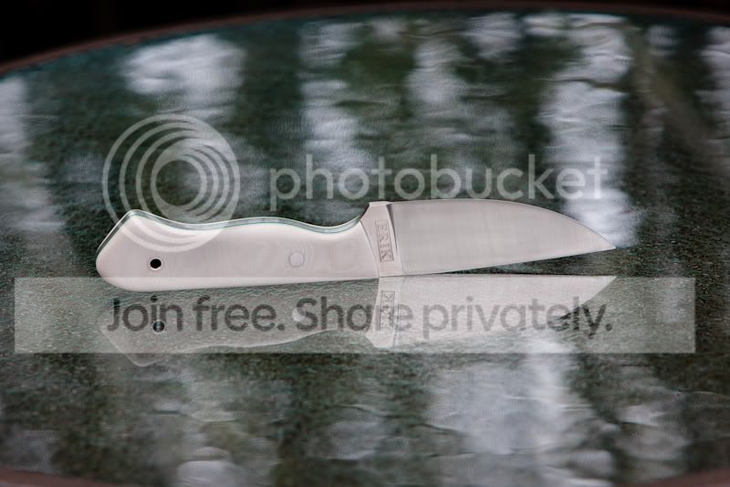

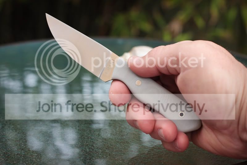

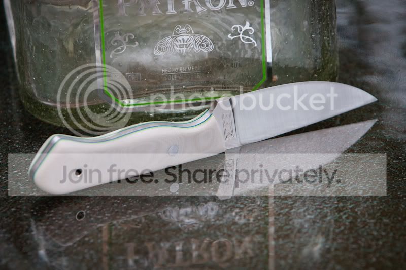

I have been light on shop time lately because of higher priorities, so progress has been slow with this batch. This one is for my wife.
M390 at 60-61 RC
1/8+ stock (.135)
6.75" OAL, 1" height, 3" cutting edge.
Grey G10 slabs w/ toxic green and blue G10 liners.
I had some issues from the start with this one, but I feel that I worked them out for the most part.

Nice, Erik! Your wife should be thrilled with that one. Really love the handle color and the liners make it pop. Great looking grinds and it looks comfy.
Happy father's day buddy!
Erik, Great work I especially like the Chef knife. That handle looks really comfy! I agree with Jonny, get some more of those done.
The chef knife looks incredible Erik. Your latest looks really good too. The scales and liners nicely compliment the satin finish of the blade.

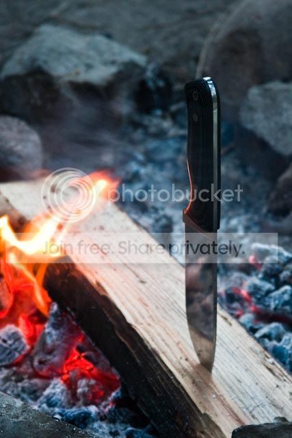

I really like the chef, and it is getting a lot of use by one of my best friends which is great. We were camping this week and took that last one and a camp knife I made a while back. It was great to put those to some real use as well.
Erik
My wife kept hers pretty clean. This one got abused, including letting my friend's kids draw it along magnesium until they made a fire - they pretty much wore out the rod in the process. :)

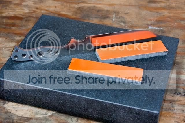

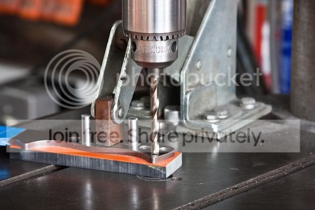

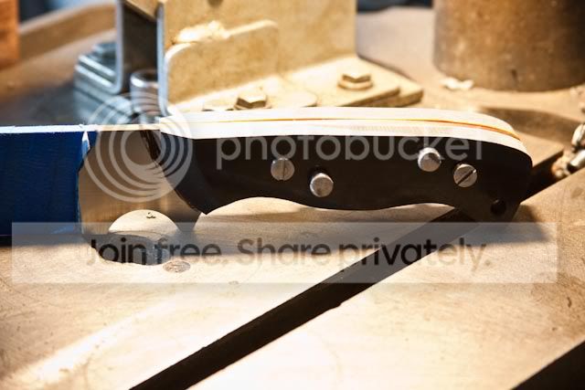

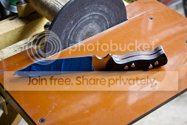

With my other batch on it's way to PA, it's time to get back to this group. I decided to finish the mini chopper next. I started this knife on New Years Day, so it's about time....
I decided this one needs corby bolts - I want it to be tough enough for abuse. I didn't drill this for corby bolts, so I added pins for shear strength and the corbys will add mechanical fastening of the slabs. I considered other ideas like hidden pins, but in the end decided that a little more hardware showing on a Harley inspired knife would be cool - we will see.

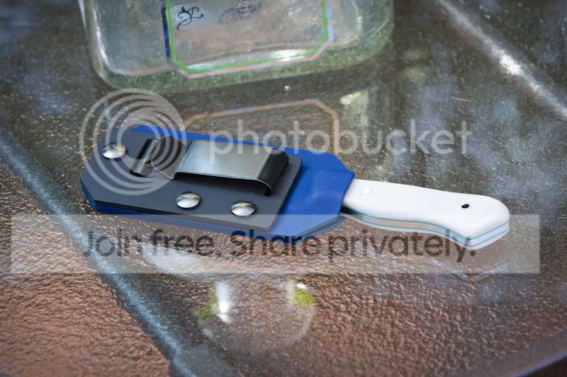

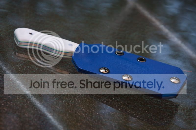

That little chisel grind knife is kool! Very clean looking little tool. Nice work, great photographs - thanks for posting.
ps How are you cutting/milling the slots in you kydex sheath? Very nice kydex work btw.
Thanks, BMK,
I've drilled and filed the slots in kydex thus far. It's a real pain. I'm going to try chucking up a Roto Zip bit or and end mill bit in my drill press next time I need a channel.
