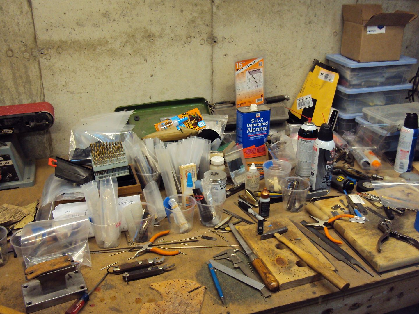

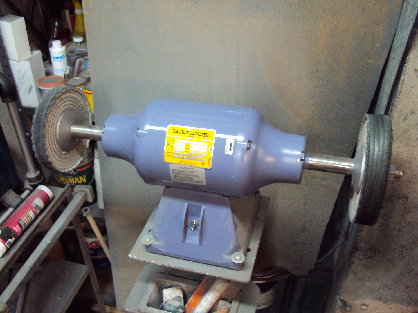

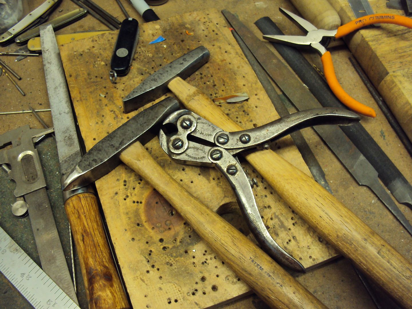

I don't want to take away from your thread, but since you asked, here are a few pics....
They say a clean desk is the sign of a sick mind, well I must be extremely sane, LOL
My stiddys...yours is great!
Here's my baby!
Thanks for the Pics glennbad! I will be studying them with considerable interest. (I have already stolen the plastic bag/cup idea - very practical way of doing things.)
Derek
There is probably a more efficient way of keeping track of things, but this works for me, and bags and cups are cheap...

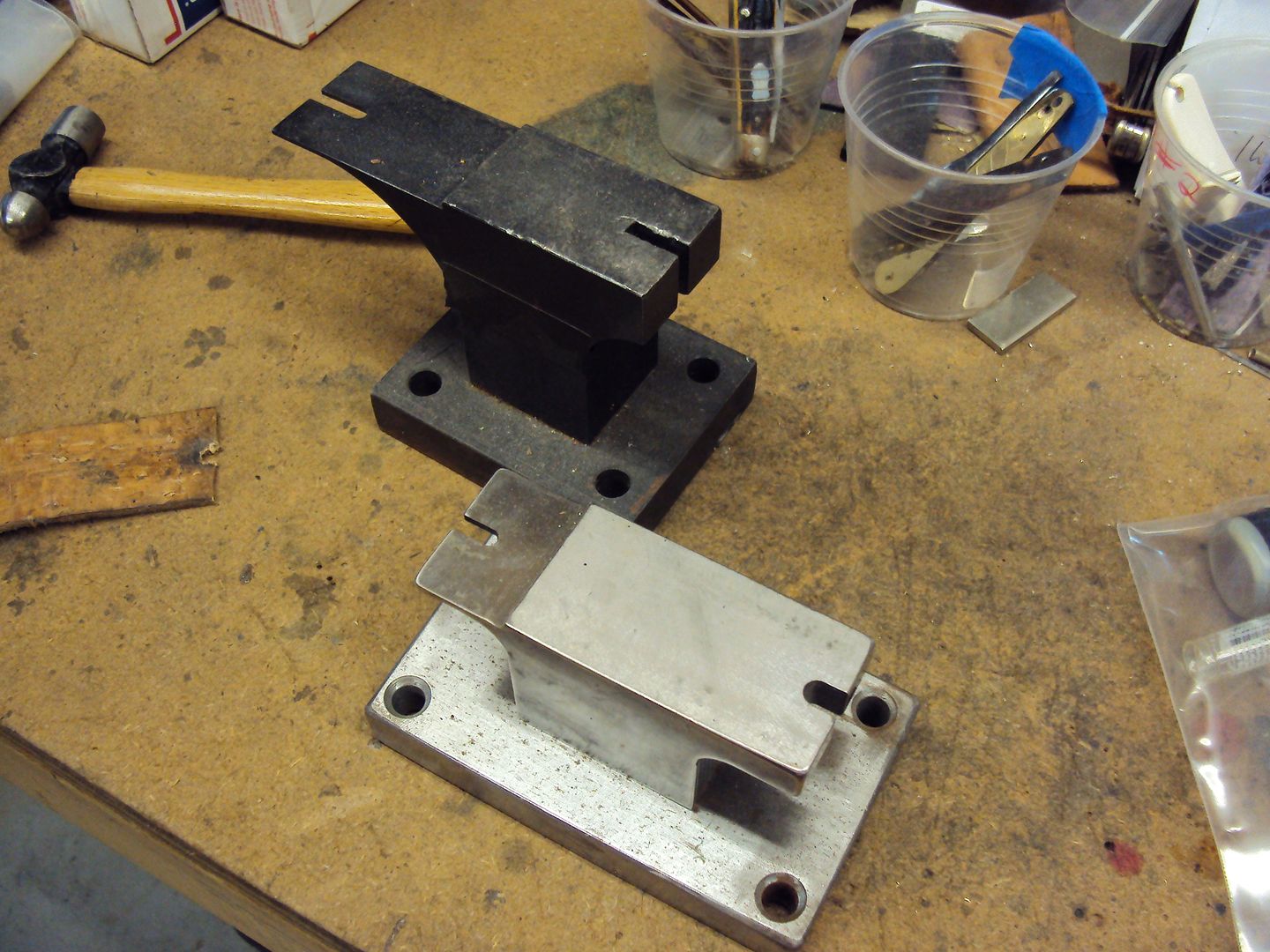

For any sort of Traditional Folder repairs or restoration one of these is very handy (if not essential) .... Mods please move if this is not kosher in this area
I’ve been getting into more & more Traditional Pocket Knife repairs and restoration and the time had come for a dedicated Anvil Workstation – This is based on the “Steady Rest” described in Ben Kelley Jn’s great little book on Pocket Knife Repair.(ISBN 0-87341-387-3)
All done the ‘hard way’ with basic tools and lots of elbow grease from a piece of tram line. This is the second one I have made the first was some smaller track and is just a bog standard anvil design.
Derek,
What did you use for the thin end of the anvil that will stand up to repeated pounding? Material? Thickness?
Both Ben Kelly's and Adrian Harris' books were on on my reading list last winter but I have as yet to try disassembling some old knives and rehabbing them.
Hi MC, The thin piece on the end is made from an old stainless wood working plane blade. Nothing too scientific about it but I reckon the tram track would not have handled being ground down that thin - just way too soft.
