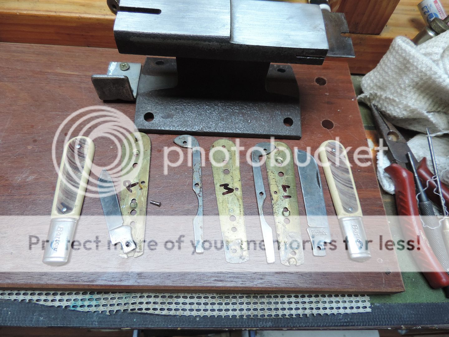

Hi MC, The thin piece on the end is made from an old stainless wood working plane blade. Nothing too scientific about it but I reckon the tram track would not have handled being ground down that thin - just way too soft.
The wood working plane blade is pretty hard, again no science in it but it is harder than all my regular knives way more than Rockwell 60 - as it only protrudes about 3/4 of an inch I think it will work okay. It is only mostly used to peen the scale pins so not really thumping on it too much.
As you can see from the pic by trial and error I got it to force fit into the slot I cut in the track (It's not going to come out without a lot of "persuasion"
