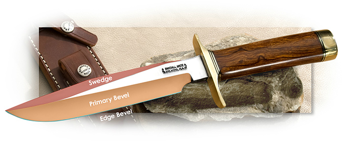

Are there knives that aren't sharpened with a bevel ?
Curious ... how are KAI knives sharpened at the factory ..?
Not that I know much about Japanese kitchen knives, but the Kai web site says, "Choose from the precision of a traditional single-bevel blade when slicing sushi, or a double-bevel blade in both Japanese and Western blade shapes."
Am I wrong to think it didn't even have a bevel ..?
If a knife does not have a bevel, then it does not have an edge.
Most Western knives have a primary bevel and a secondary bevel, where the edge is formed by the secondary bevel, and the primary bevel is the sloping area between the secondary bevel and that part of the blade where the two sides are parallel to each other. Some people reverse the meaning of primary and secondary.
Some knives have only an edge bevel, such as pure scandi grinds, although a scandi may also have a micro bevel.
A chisel grind is beveled only on one side.
Pictures would make this clearer. I don't see any really good ones at the moment, but maybe this will help:
From agrussell.com.
