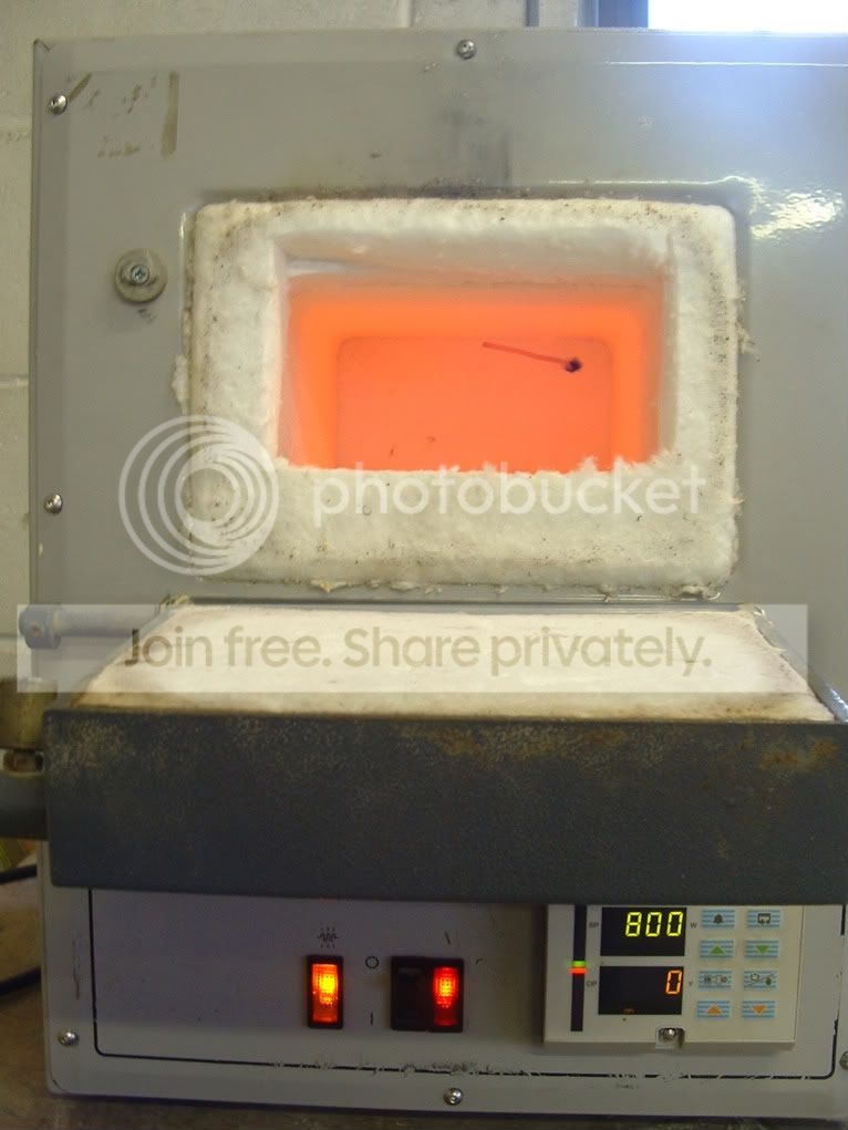

I've been lent on a semi-permanent basis a Blue M lab oven to use for heat treating.
The control is pretty crude, high, med, low power and adjustable cycle time. I was able to get it tuned to fluctuate between 1508F and 1481F on a cycle (I didn't time the cycle while I was out there but 10 to 15 seconds I believe) The oven lost temp pretty quickly while the elements were off.

A PID controller is definitely worthwhile if you have the electrical ability to change it.
The ITC-100 is an infra-red reflector and will give no benefit at all in this application.
I'm not familiar with Blue M products, but assume you are referring to one of the 1100 degC Lab furnaces, presumably an older model from your description of the control.
The description of the current models suggests that the muffle construction is very similar to the Carbolite lab furnace I had a few years ago. I fitted a PID controller to that and found I could get pretty good control at steady state and could also get minimal overshoot on full heat-up.
The biggest limitation seemed to be the fact that the elements are buried in insulating material and there is a timelag between the controller applying power and the thermocouple seeing an effect. The autotune did a pretty good job and the control was fine on an uninterrupted run, but if the door was opened and closed again, there was overshoot as the temperature tried to get back to the setpoint.
I think with a basic PID controller, it will be fine for single blades where you can put the blade in a cool furnace, bring the blade and furnace up together, open it and quench (it doesn't need to start from room-temperature cool, just far enough below the setpoint for the controller to see it as cool: switching off for 5 minutes between blades would be ample).
If you are looking to batch-treat, opening the door, taking out one blade and closing the door, you may find the first and last blades out perform differently.

Even if you go for a cheap ebay controller, I'd recommend using an SSR and programming a 2-second output cycle time.
If it's practicable, building a separate control box that you can plug pretty much anything into is a good way of dealing with things. It minimizes your interference with the lent unit and puts you about halfway to a homebuilt HT oven if you decide to go that route in the future: I find the costs split is roughly half on the control box and half on the oven itself when I build them. Obviously YMMV.

This is what the unit looks like (not mine but better pictures than I can take in my garage right now. http://www.used-line.com/PicturesAuto/643/10388643.jpg
The analog temperature sensor isn't working but I compared mV output of the thermocouple to direct readings by thermometer in the chamber at lower temperatures and the Thermocouple is still working fine.

The photo shows the elements visible from inside the chamber, so you will not have the lag that I thought you would: Mine had the elements separated from the chamber by a layer of insulation:
The fluctuation you mentioned may have been on the same time period as the output cycle of the controller: rising as the elements are powered and falling as they are off, to give a saw-tooth temperature profile. I've seen this myself. Reducing the cycle time reduces the size of the saw-teeth and about 2 seconds seems to be as good as it gets in my testing. A cycle time this short really needs an SSR. I saw no improvement when I tried going to 1 second cycle time on my home-built ovens, but I am on 50 Hz mains and 2 seconds seems to be the minimum recommended for 50 Hz.
