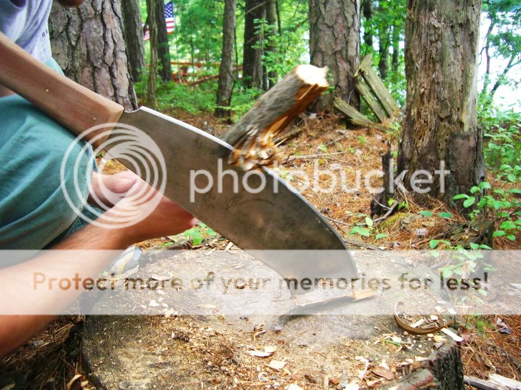

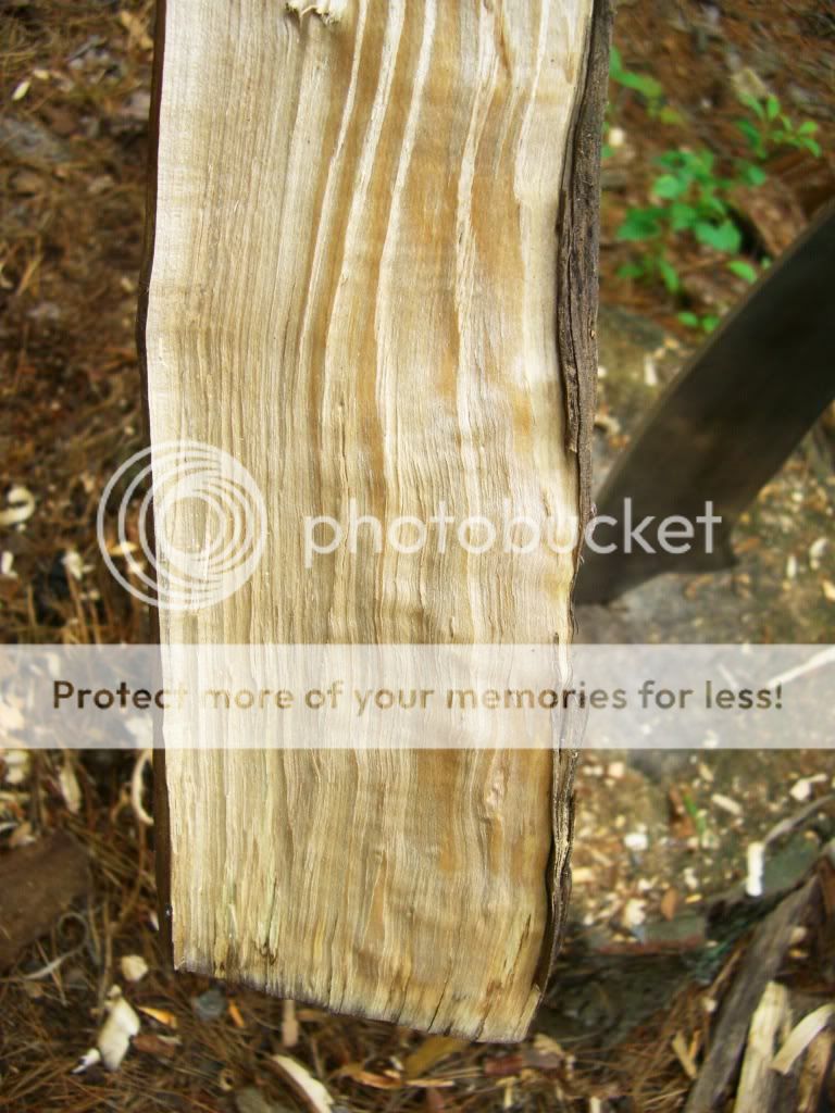

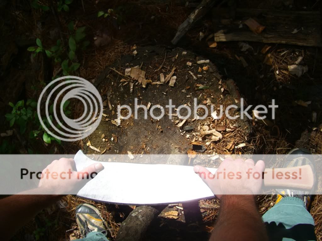

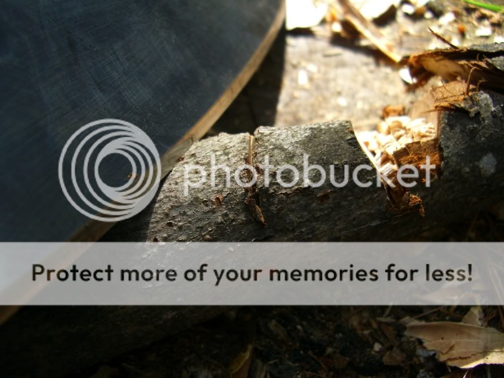

The projection on the back is sharpened about halfway down the spine and is used for cutting lighter targets like grasses, brambles, woody plants, etc. It can also be used as a pick, and the "crotch" of the two blades can be used as an extension of the hand to push brush out of the way. Furthermore, it also serves as a nice hand-stop when being used as an improvised draw-knife. When held with the hook facing forward the mass of the blade is trailing, making it faster in the hand and allowing you to get the tip speed needed for cutting light targets. The sweet spot is a full 7" long and runs from the widest point of the belly all the way to the beak of the hook.

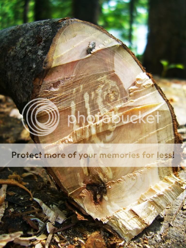

I'll be heading to my family's camp on Friday and plan on doing a battery of demos with photographs to show some of the various functions.
