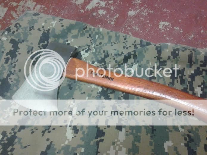

Picked up the C-Man hatchet yesterday. They only had 2 left in stock and this one had the better grain in the handle, now I need to sharpen it up and then remove the varnish on the handle and clear coating on the axe head.....What's the best method to remove the clear coat on the axe head ??

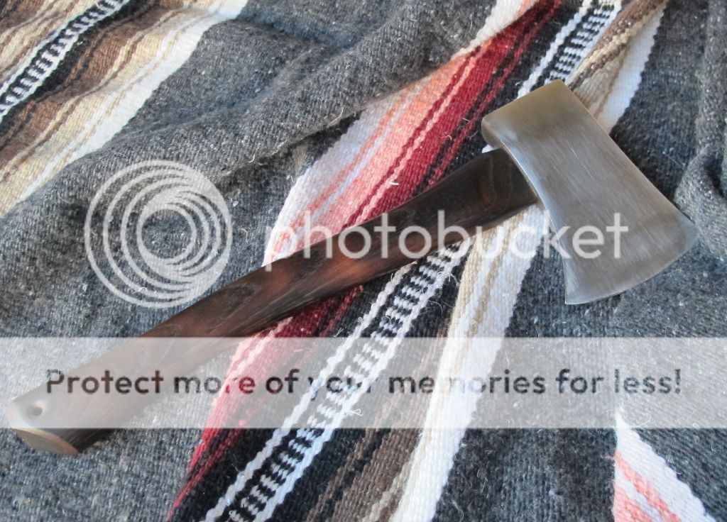

I used acetone to remove the varnish on both the handle and the head, I then sanded the head with 400 grit wet paper and burned and waxed the haft.
I might have to look into using acetone......you did a good job on that hatchet :thumbup:
A brass wire cup brush on an angle grinder will remove the finish without scratching the steel below.
Compared to the similar priced Council Tool hatchet I think this one's axe head is better shaped and it has a half inch more cutting length than the Council Tool hatchet.
