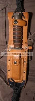

Now I just need to mod the sheath to hold a firesteel in addition to the sharpening stone :)
you must have been reading my mind. I've been thinking about how to do that too. I'll try to get a mock-up of what I was thinking later today.

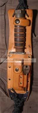

Here is my idea for adding a firesteel to my "new" knife
My plan is to simply take a small strip of leather and make a nice tight loop that is just a little to small for the steel (I'm going to get a LMF Army for this) then wet form it to the steel and rivet the loop to the sheath.
Thoughts?

On the side like that it might be too prone to catch on things? How about mounting it along side the stone pouch? A little more compact and protected there I'm thinking.
Good point, I was going for the super simple easy...but as with most things in life that's not the way to; a little more time and effort usually pays off in the end.
Do maybe something more like this
I'd place the firesteel loop on the other side of the sharpener holder. That way, whenever you're rumbling through brush that can grab at you, branches slide over the firesteel instead of getting hung up on it and yanking.
Other'n that, I like the idea and think you've done a great job with the mods.

I thought of that after I posted it up and looked at it and went d@mn should have put that on the other side, and since I've been processing wedding photos all day I really just didn't want to do anymore photoshop work tonight.

It might be easier to rivet the fire steel holder to the flap of the stone pouch.
Or buy one of those pull apart key rings and put the fire steel on one end and attach the other end to the sheath.
