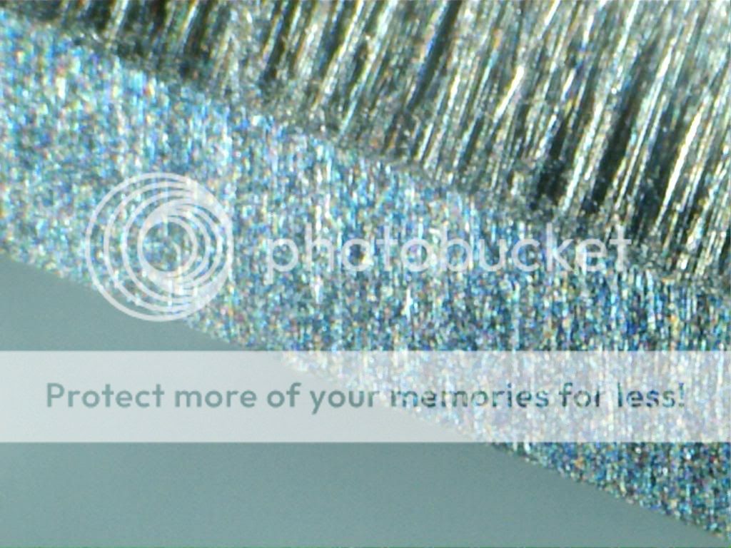

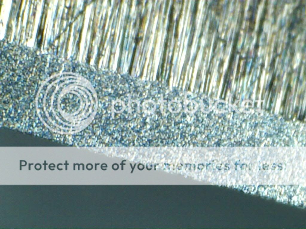

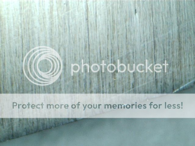

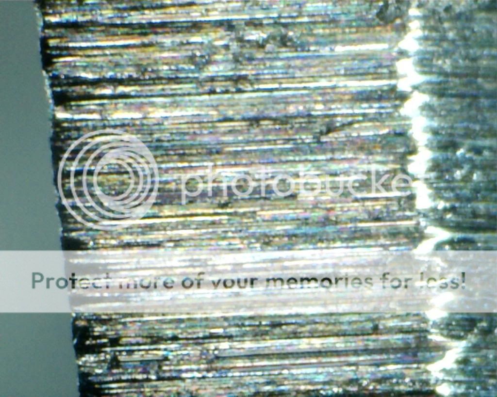

In regards as to why , here is why I feel that the Veho is the best you can get for the money spent.
Maestro Wu , Factory Edge
Maestro Wu , My Japanese Natural Edge
Dovo , Factory edge
Dovo , My Jnat Edge
Cold Steel 4116 , 8k Shapton stropped with 1u CBN on Roo

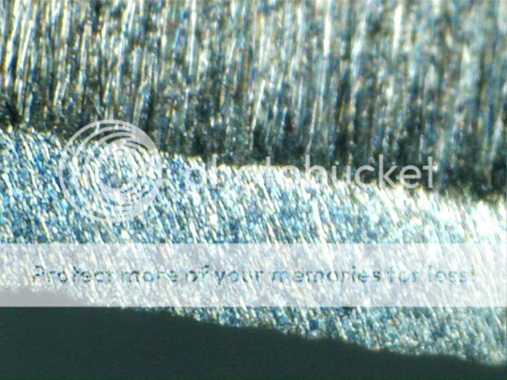

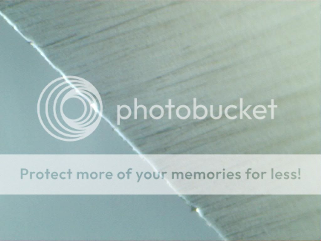

Its usefull for tracking down problems and seeing what is actually going on at the edge of the edge. Like in this case I had some leftover scratches (probably atoma 1200) that were really messing me up , these types of things don't always showup until later on in the process...
Dovo , Meara w/ Atoma Scratches
Dovo , Meara Properly Sharpened
Dovo , Mukaida Jnat , just did this one 5 minutes ago :)
I have yet to find anything that hooks up to my PC , and gives me such great images , for 60$ , theres a couple other brands out there (dinolight?) , but I think they are basically the same thing only slightly more expensive. There are better microscopes out there , but unless you already have access to one , even I wouldn't spend 1000$ on a microscope just for the purpose of sharpening knives. 400x shows me everything I need to see , and as you can see , takes some great pictures with some practice.

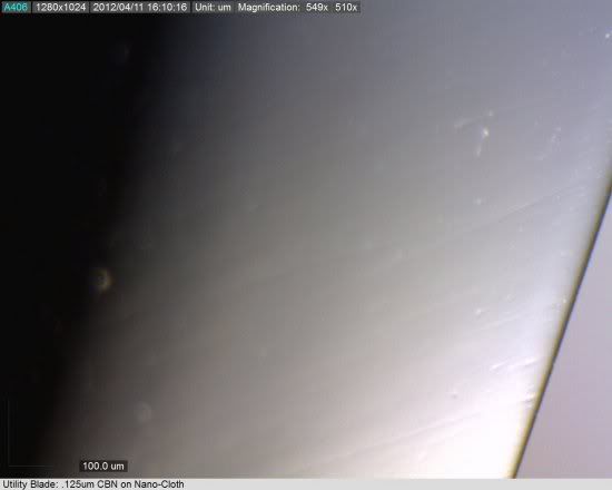

Can you take a similar photo of a mirrored edge? I would be interested to see what it looks like at the same magnification.
Compliments of CKTG
Mine are still coming along. It takes many many many passes to get results like above. Mine were 200x with each strop , or 100 per side.
