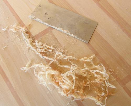

Take one thin 1" x 2" carbon steel Lee Valley cabinet scraper:
http://www.leevalley.com/wood/page.aspx?c=1&p=32672&cat=1,310,41069&ap=1
drill a lanyard hole into it, attach cord and do the following:
scrape a pile of shavings from a piece of wood with the scraper, then run the scraper down the firesteel. The thin highly flexible spring steel scraper will "flick" one hell of a shower of sparks onto the shavings.
$5 for three 1" x 2" scrapers, Rc48-52. . They make a pile of tissue thin shavings in no time, much better than a knife in my humble opinion. The shavings are very curly, thin and ignite very fast. These little scrapers also excell at shaving magnesium bars and are extremely excellent strikers for fire steels.
:thumbup: ENJOY!

A couple of weeks ago I tried putting a mushroom edge like is proper for a cabnet scraper on the back of my 2 inch piece of hacksaw blade I was using to scrap the fire steel. It worked pretty well.
Google "sharpen a cabinet scraper" for video and verbal instructions.

here is one link, with a great pic of the little curly shavings
http://woodgears.ca/scraper/index.html

Not sure it would work that well (the knife that is), might be wrong though. The spine of my A1 is well squared. Strikes great sparks but doesn't scrape curls.
Sharpening the scrapers means making a deliberate burr along the edge with a burnisher - that is what cuts the curls. Knife steel might not take this burr so easily, and I probably wouldn't want to do it anyway.
The slim bit of steel is barely bigger than a hacksaw-blade ferro striker, so it seems a good replacement.
