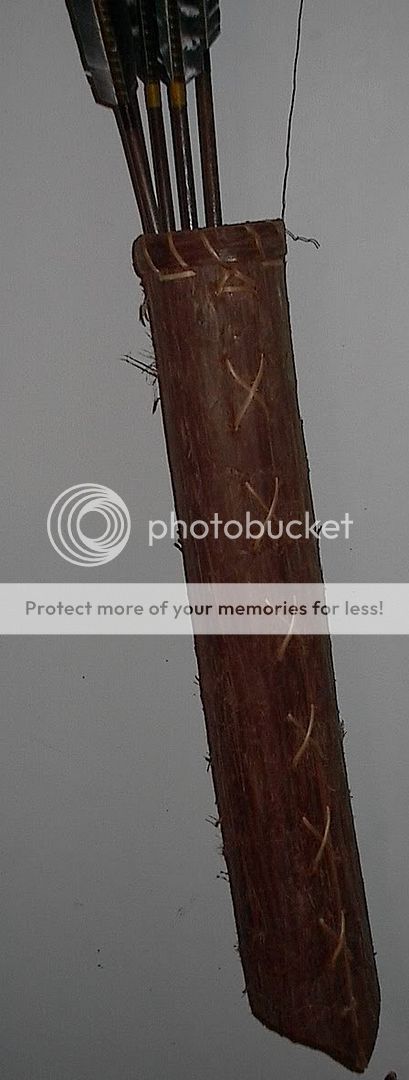

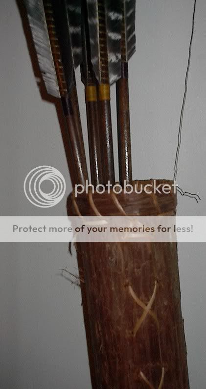

I used it for lacing in this Cedar bark quiver (not a good choice as Cedar (Thuja occidentalis) is pretty fragile. If you backed up against something, they would crack - looks good on the wall, though :o):
You can coil Spruce root and store it until you need it. Then soak it and it will regain its flexibility. It also lends itself to be readily split, and split again to gain the size of cordage/lacing that you want.
