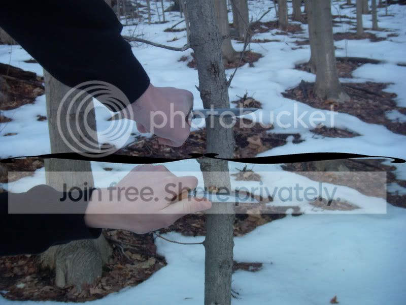

because one of the main reasons that people seem to like carrying large blades and hatchets etc is to cut poles for building shelter, i thought i would make this post.
i don't really like carrying alot of extra weight, and i don't do that much building while on the trail anyways, but if i needed to, i could.
How To Cut Down a Small Tree With a Little Knife

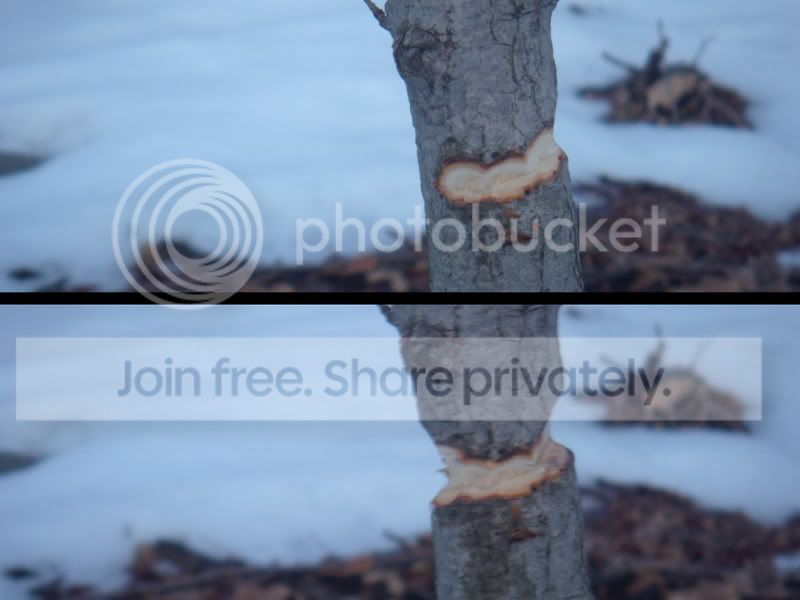

1. cut a notch into the tree, deeper than the bark so that you actually bite into the wood.
2. cut similar notches all the way around the tree in a ring.
3. cut the notches a little deeper.

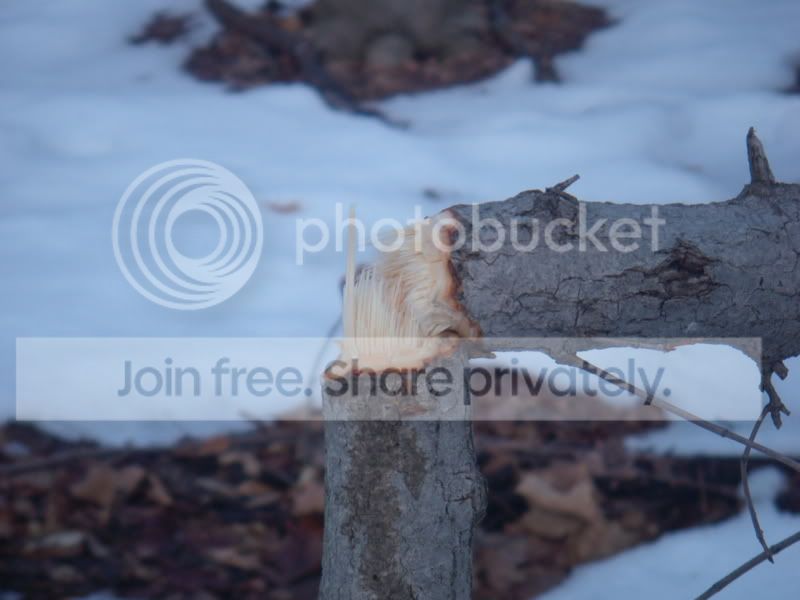

4. force the tree over with a shove. if the notches were deep enough, the tree should break off right where the ring was. you might have some fibers that are still clinging. just slice these off with the knife.
i find that this technique takes about as long as hacking with a hatchet or larger knife, it just takes a little more attention.
just a good little bit of knowledge that is handy for those that don't like to carry alot, or those that don't have the luxury of a chopper (as in many likely survival situations)

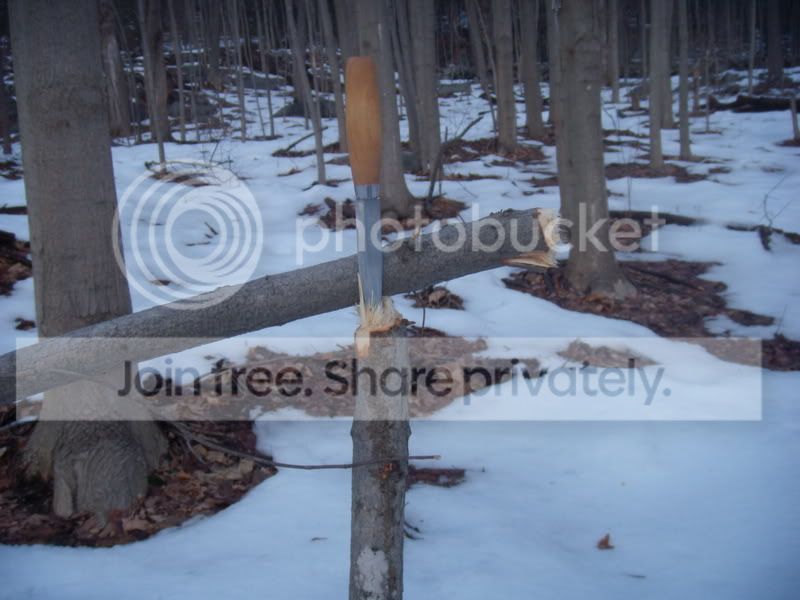

note that i used a small mora (3.75 inch blade) to do this, but it can be done just as easily with a small penknife or other folding knife. frequently when heading to the woods for a quick little jaunt i forget my mora and practise skills such as this with just the knife i have in my pocket.
hope this is helpful.

Actually, there is an easier method...if I understand you correctly. I have cut literally hundreds of small poles over the years in a number of my classes using just a sharp fixed blade (a Mora works great). By putting the grain of the wood *under stress* by slightly bending the pole, you can easily shove your knife blade straight through the pole without making notches. Sometimes a little rocking of the blade is necessary. Still, I prefer a small handsaw for pole cutting if one is available.

ah yes dannyboy i had forgotten about that...i use it sometimes but i find that i have to make a few cuts anyways, and that it is less precise because of the way the wood splits.
it is a good technique though.

I know the method you mean bro but I don't think it would work with the size diameter of the wood in the pics, you would have to be superman to put any significant bend in that in order to put the fibres under stress !

It is worth pointing out that the Mora is cutting hardwood an the Golok is cutting pine. BTW Siguy, where in CT do you live?
