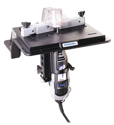

I use a dremel router table with sanding drums, just like this. It works like champ for me...
You can take the jigs out and do the rounding free hand. Thats how I do it anyways. It is not so fancy but it is safer than normal router, I was struggling to get good perpendicular rounds, this table solved my problem. Also I use this to get perfect flat sides with those jigs and with diamond tips to make cutouts and guard slots on metals freehand ... Best side of this table is it is very cheap :)
