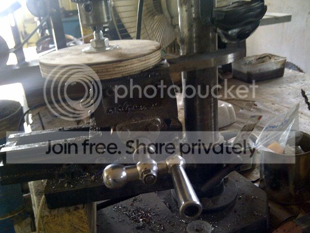

bluerain, most of it has been said, except that you can quite easily make a passable "surface grinder" from your drill press. It may not work to one thou but you can certainly get close enough to make constructing and fitting folders a lot easier - and flatting steel as well as getting sides "paralel" on fixed blades. I'll try to remember and take some pics tomorrow.
Here's a pic - it's not a commercial surface grinder by any stretch of the imagination, but if you true and square things up well you can get to pretty close tolerances with a little practice. I use a contact glue to stick the sandpaper to the bottom of the disc - the heat seems to take care of it not sticking too hard and every so often I just put a piece of sandpaper on a block in the cross slide vices, makes sure it is all squared up with the chuck and the disk, and sand the disc face clean.
