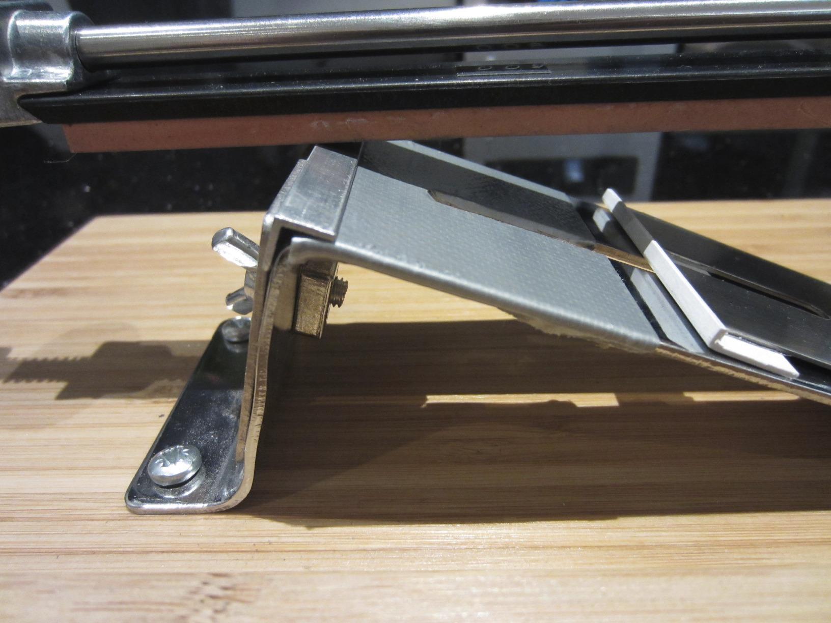

2 things which bug me:
  1. the ruixin frame has a chrome-like shiny coating, and that coating is easily damaged/scratched, and once it is, the main material (metal) starts rusting right away. cheap sheet metal material, not a big deal.
  2. the right angle of the ruixin frame is rounded in the vertex, basically eliminating the vertex through the existence of an annoying radius. having a rounded edge, where your knife is to lie, **cks and causes problems with small/narrow blades. bending a metal sheet to a 90degree angle will always entail a radius ("bending radius"), so i am just saying that a much smaller bending radius (or no radius as with the Edge Pro Apex) would have been much better. cheap production process.
I saw the forward blade support in the Hapstone M2 Kickstarter video and didn't realize that the Ruixin has it too. This basically eliminates the no.2 which bugged me: the rounded edge!
Imho the SS plate is fixed best in the horizontal label orientation. If you don't need the support, you can just leave it in this lowest position:
And if you need it, it is easily deployed. Even with the 3 magnets installed flat next to each other, nothing obstructs the SS plate fixture at the highest level (in horizontal orientation):
Interestingly, at this highest level, the forward blade support is exactly(!) plane with Ruixin plane, i.e. a flat blade doesn't get lifted up by the forward blade support. Looking from the side/profile view, the blade contacting area forms a straight line touching both the Ruixin plane fully AND the forward blade support:
One could also clamp an angle iron (angle steel) in between, if that's your preference.
