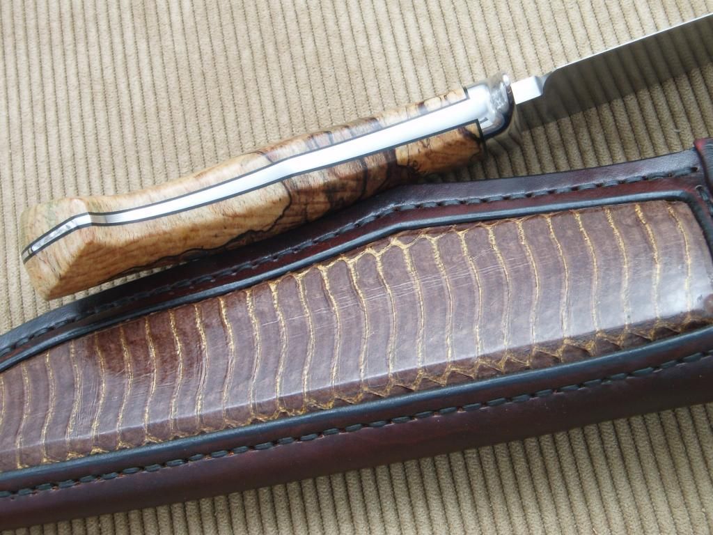

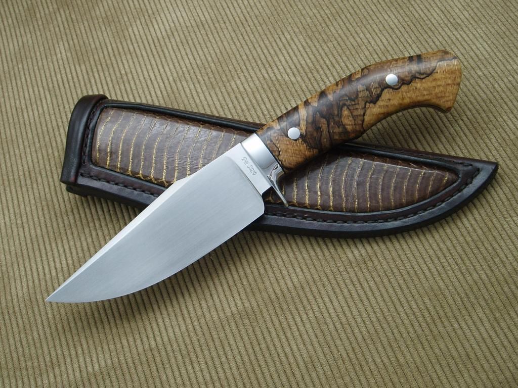

Just finished up the sheath for this large hunter come camp knife. Harpoon style blade is full flat ground ATS34 with a satin finish and a full tapered tang. Guard and corbies are 416 stainless. Scales are beautifully marked stabilized spalted maple with black fibre liners. OAL 10" X 5 1/4" blade.
The inlay material is snake skin cut to show the belly scales. Thanks for looking gents.
Lovely piece of work there, love the continuity on the grain of the scales. Great attention to detail.
Looks fantastic!
Thanks everyone. Highly recommend the spalted maple, I've never been a fan of light coloured timbers but this stuff really pops.
