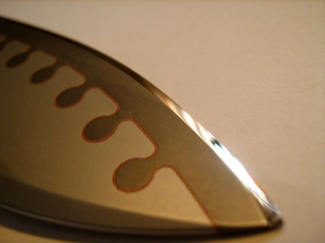

A knife can be sharp on many levels, from finishing with just a fine DMT or using ultra fine stropping compounds for that mirror finish. I think it also depends a lot on ones sharpening skill and their tools, I can remember the day I got my medium spyderco ceramic and realized that "yes" my knives can get sharper. There has been a lot of progression sence then and my skills and equipment have gotten a lot better. I have become accustom to a very sharp high polished edge and can tell the differences when cutting with a lesser edge. This is not to say that I won't do a field touch-up with a UF DMT and be happy with it but when I get home its the full treatment.
Its even sharper than it looks.
knifenut1013, I always enjoy looking at your knife edges. They look extremely well done.
Thankyou, its taken a long time to get here.
It's a multi step process that finishes with 0.25 micron diamond paste.
The green DMT is about the half way point.
