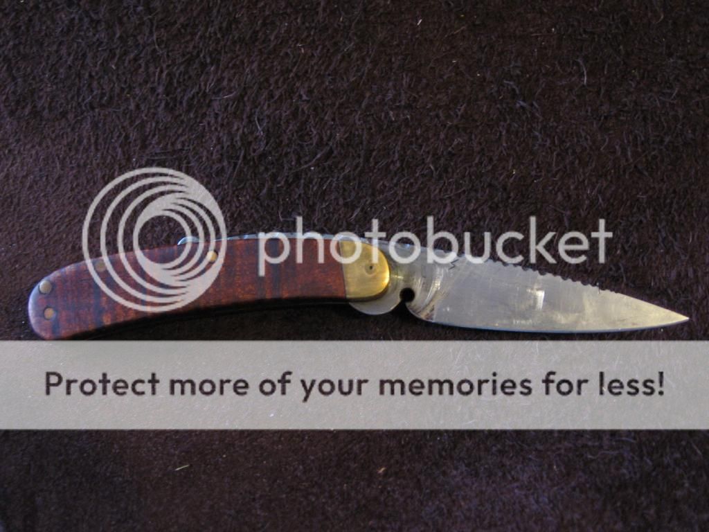

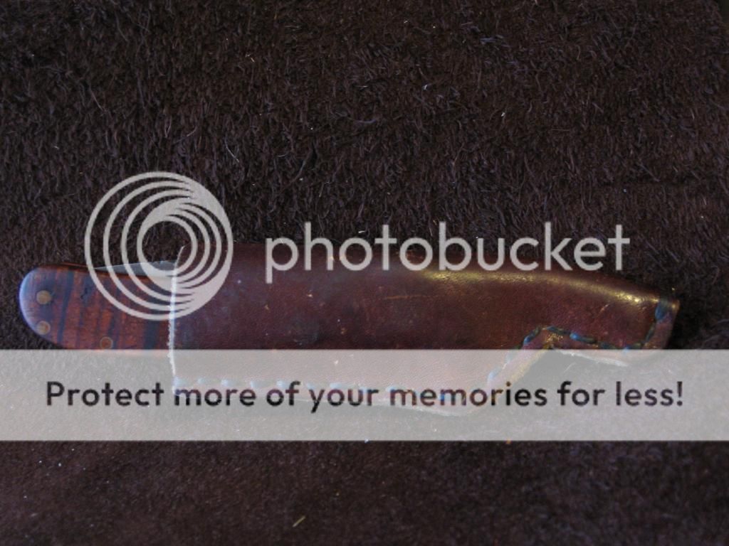

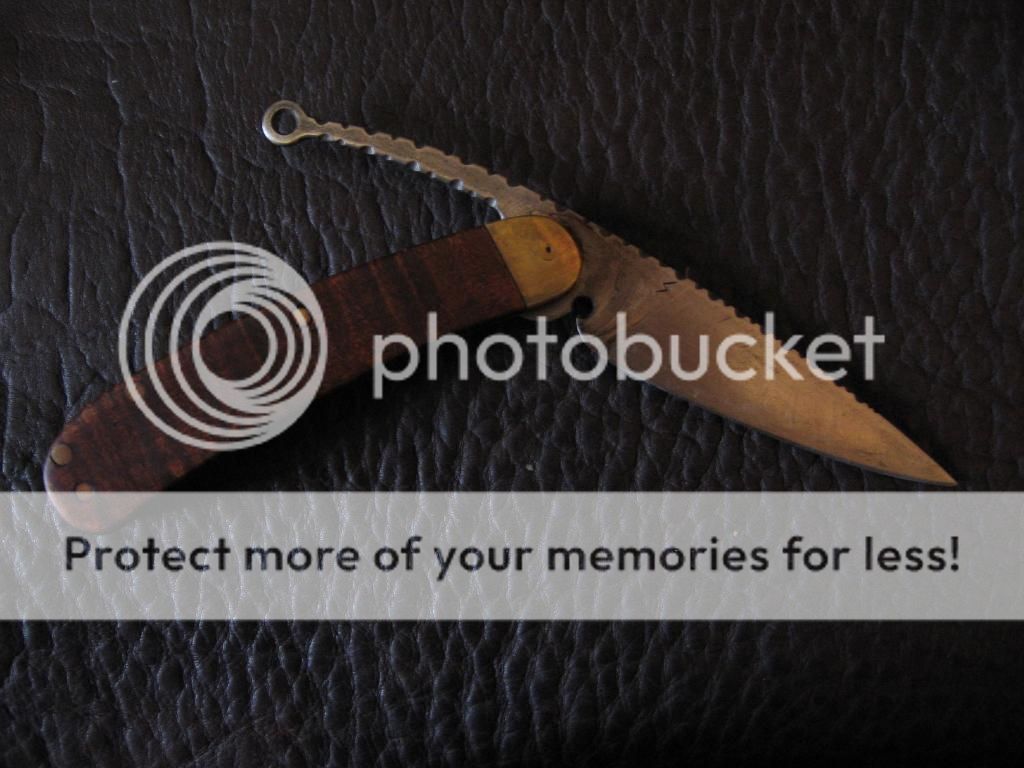

I made this one about 20 years ago, the curly scales from a load of firewood ;-)) I flush ground the pivot pin
but the brass liners hold the blade nice and snug. Had to center punch the pin a couple of years ago to snug it up.
I use it for hard dirty outside work so I made the lever extra long for a little extra control on the blade.
Bet regards
Robin
