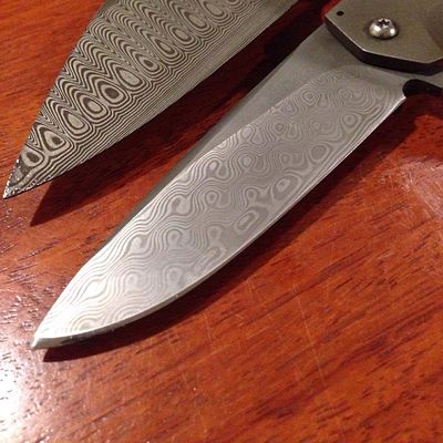

I wouldn't recommended vacuum furnace for damasteel since the longer soak time will dramatically effect the etching.
Do you mean damasteel treated in vacuum oven will require longer soak in acid when etching?
Vacuum furnace naturally require long soak time (like 2 or 3 hours) due to the huge chamber size and amount of work pieces normally put in.
Longer soak time will likely to dissolve more Cr carbide and put higher amount of chromium to the solution that will effect how steel react to the acid. In the picture the worse contrast piece is HTed by vacuum furnace.
here's on I just did using the parameters I outlined earlier, etched in muriatic acid and then 50/50 FC/vinegar per the Todd Begg YT video
