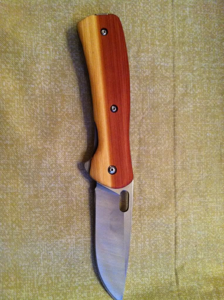

Okay, I wasn't really happy with the cherry wood scales and put the stock ones back on yesterday. Then I started thinking about the cedar 110 I did for my cousin. So I cut out some cedar slices and put them in my wood hardener vacuum chamber I made to soak some wood hardener all the way through. I cut everything out which was easier to do this time since I knew how to do it already. Finished with a little CA glue. I'm much happier with this set. I rounded them over more so they fit more like the original scales.
I took a glass jar and mounted a fitting for and AC vacuum pump on the lid. I can't remember what the fitting is called but it's where you would hook up the gauges to the AC. And I just filled it with Minwax Woodhardener. Attach the hose and pump the air out. But you need a good size jar because it foams up a lot and you don't want that stuff getting into the pump. Now this isn't the way the professionals do it. It won't give you the shiny hard finish like they do but it definitely makes softer woods harder. Cedar is fairly soft so I wanted to help it out some
Wow. I didn't know folks were making all these different wooden scales.

The wood looks great.:thumbup: I got my son a Vantage for Christmas to replace the one we make macarta handle for. It got it's self lost.:(

I have a Vantage Select large and was wondering if it's worth it to put those wood scales on this knife. Any thoughts?

I think so. thats why I went for the Avid model. I really like the wood look on the Vantage. I may still pick up a Select and Pro, just because Im really into the Vantage. LOVE this knife!
